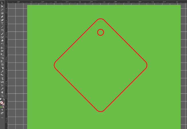

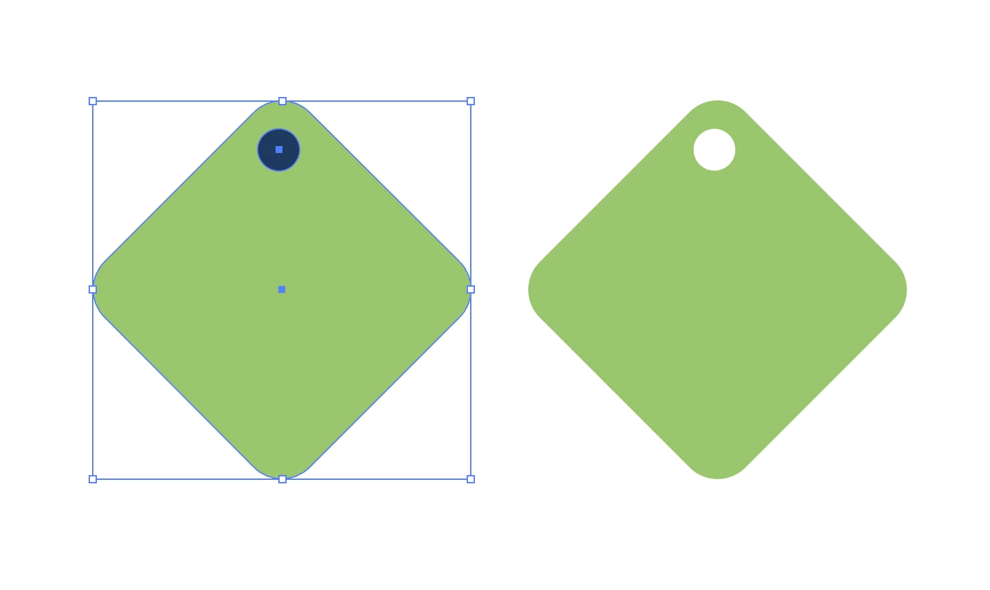

Hey guys,
I'm still learning how to use illustrator but I created a compound path from a hexagon with a hole at the top (to be a keyring). The issue is that when I try to use this as a clipping mask, the hole at the top doesn't seem to be registering as the clipping mask if that makes sense. The screenshot with the red outline is the compound path which I placed over a green square, but when I use it as a clipping mask, as you can see in the other screenshot the hole remains filled in. Does anybody know how I can fix this or what I might be doing wrong? I need the hole to remain a hole/transparent. Any help would be appreciated!

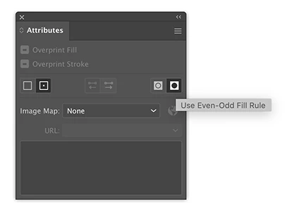

Correct answer Ton Frederiks
You may try to select your compound path/clipping mask and change the attributes in the Attributes panel.

Ton Frederiks
Ton FrederiksCommunity ExpertCorrect answer
August 5, 2021
aiturtleAuthor
August 7, 2021
This fixed the issue- thank you!!! Can't tell you how long I've been stuck on trying to figure it out

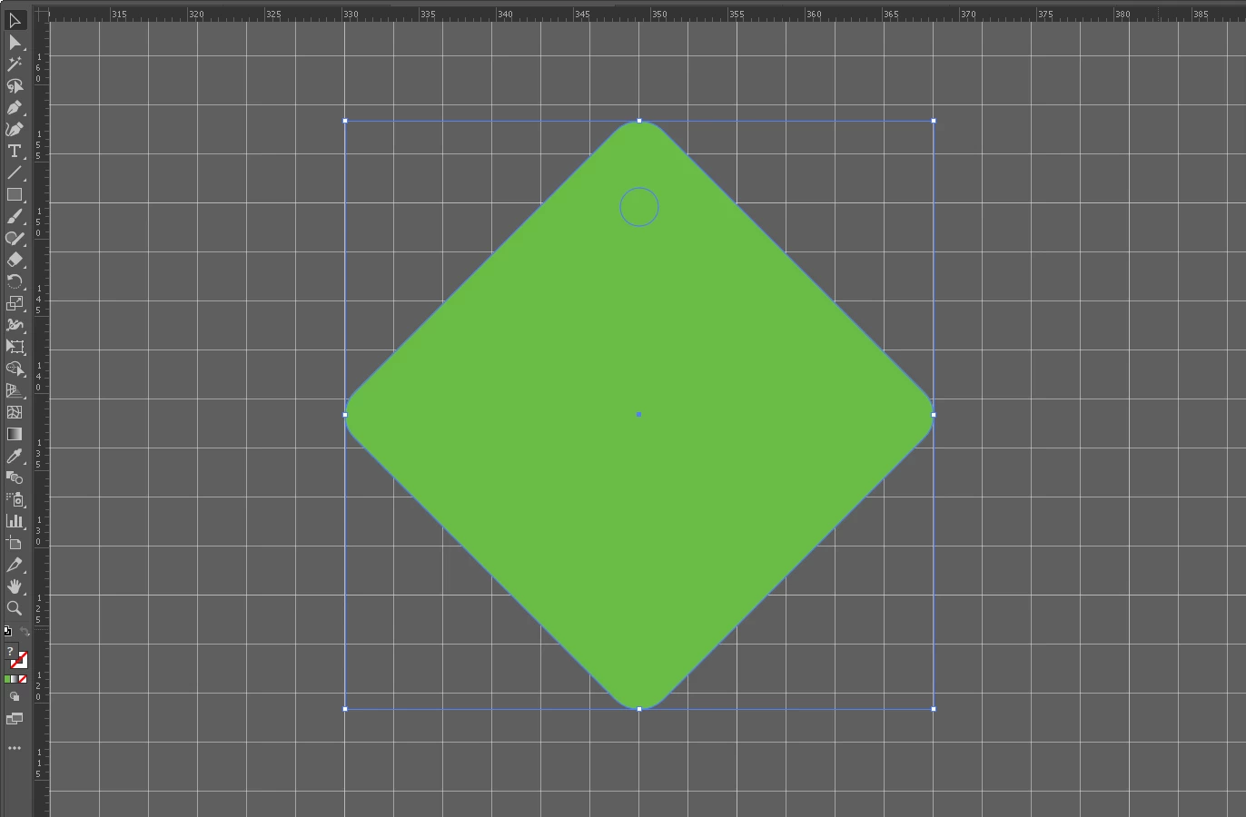

Select your compound path (red stroked shapes) and use a fill instead of a stroke (Shift+X) to check if the hole is filled or not.
If it is filled, perhaps look in the Attributes panel and change the fill rule to Even-Odd.
I'm not 100% sure why you need it to be a clipping path if you're just filling it green, but perhaps there's something you're not telling us.
aiturtleAuthor
August 7, 2021
Haha was just filling it green as an example to show what I meant, but thank you the fill rule to even-odd fixed the issue!
