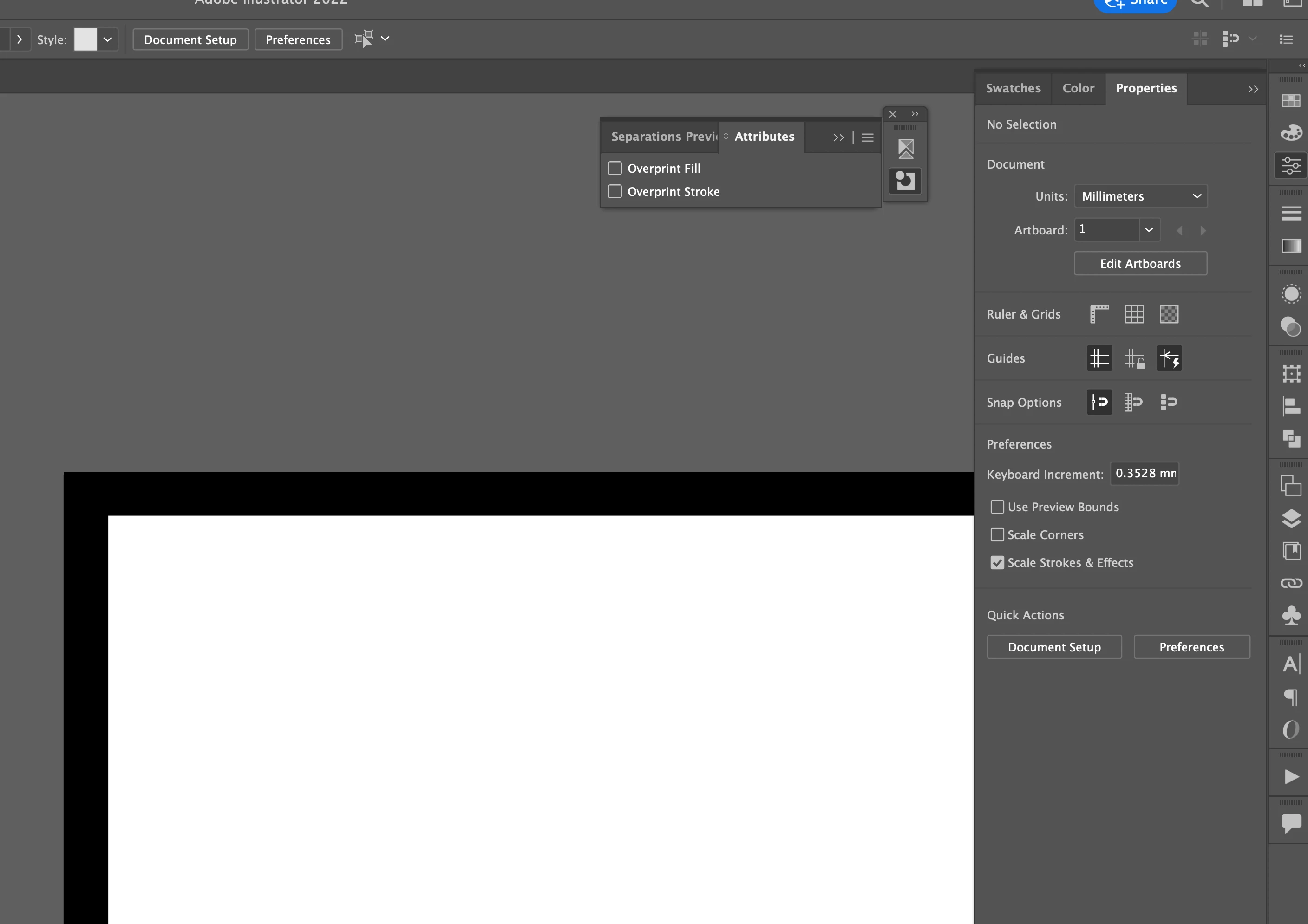

HOLA
NO SE SI A ALGUIEN LE HA OCURRIDO QUE AL SELECCIONAR UN OBJETO NO TOMA LA MEDIDA DEL PATH SI NO QUE TOMA LA MEDIDA DEL TRAZO (GROSOR DE LINEA) HAY ALGUNA FORMA EN DODNE SE CONFIGURA ESA SELECCION
GRACIAS
pixxxelschubser
December 27, 2022
If I understand you correctly:
in your screenshot there is a checkbox: Use preview bounds
  • Deactivated (as in your screenshot) it always takes the pure dimensions of the path. A contour thickness is not taken into account.
  • Activated it always shows the path plus contour thickness.

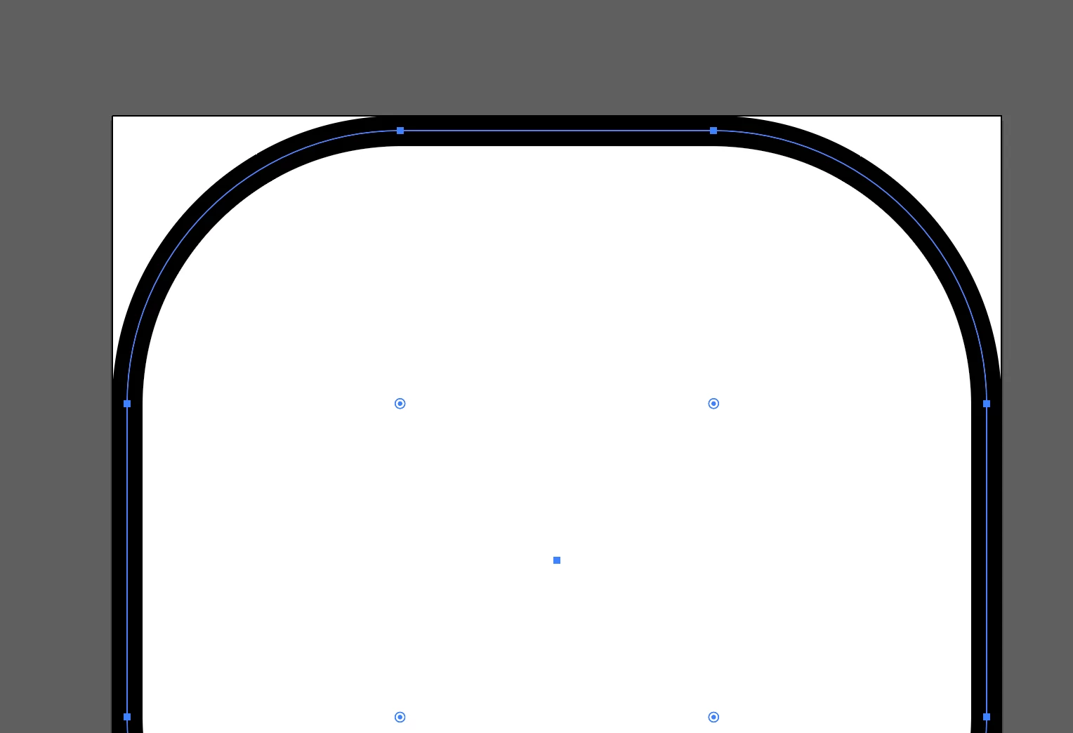

MAS BIEN ES AL REVES NO RESPETA EL TRAZO  MAS BIEN TOMA COMO LIMITE EL GROSOR DE LINEA
MIRA EN ESTA CAPTURA SE APRECIA MEJOR EN DONDE DEJA LA MESA DE TRABAJO EL OBJETO ESTA SELECCIONADO
pixxxelschubser
December 27, 2022
Ok. That's weird.
I thought it worked for me in the past.
Suggestion for a quick workaround:
  1. set the contour to "Align contour inside"
  2. then change the size of your artboard
  3. change the contour back to centre or outside.
