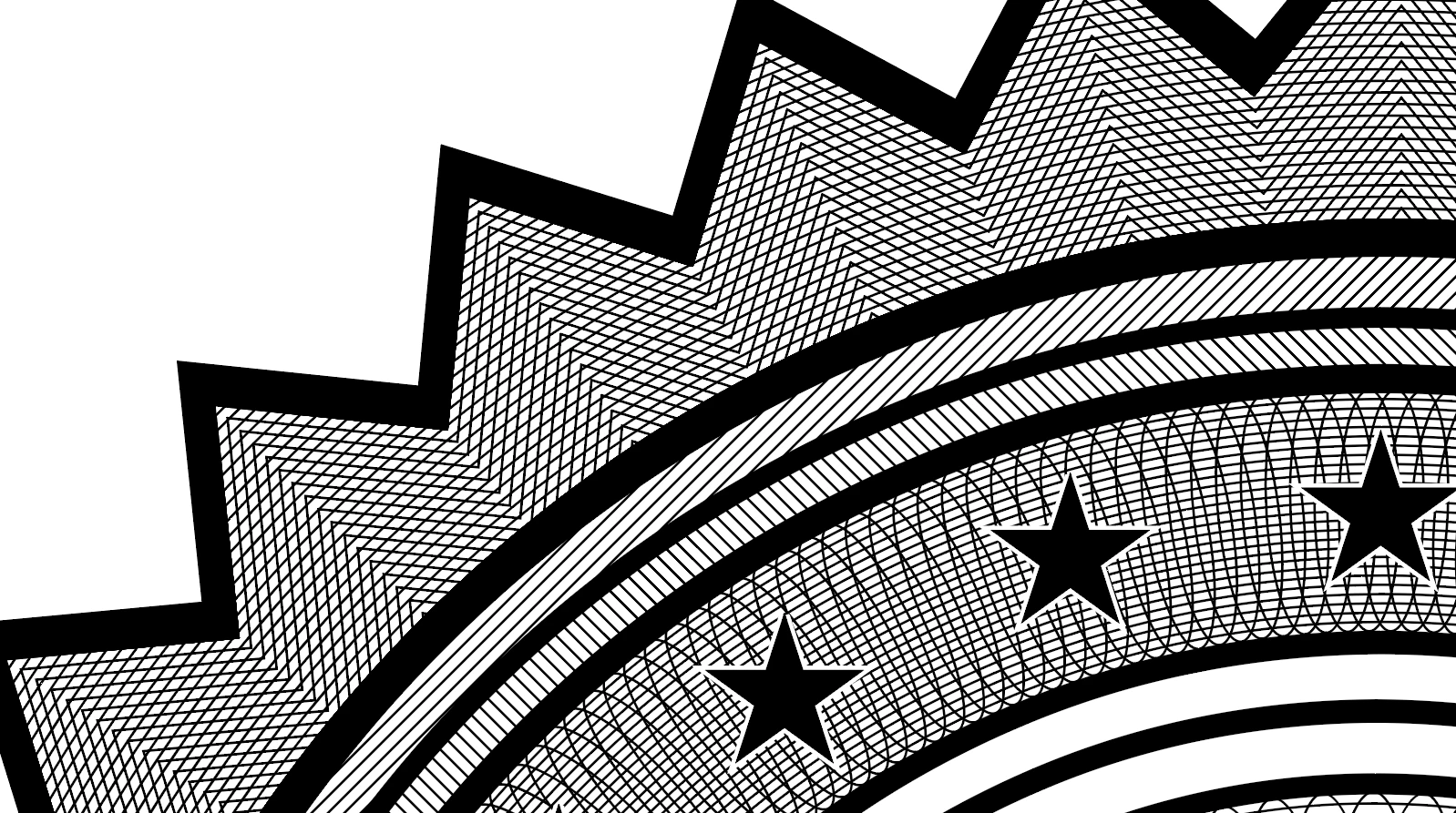

Is there an easy way to convert a black-and-white PDF/AI to a file with 'clean lines'?

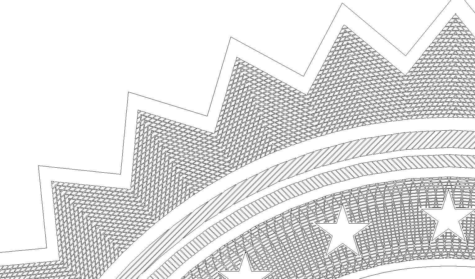

A black-and-white file can look 'clean' at first glance, but if you type CRTL+Y in Illustrator, you see al the hidden lines. Most of the times there are a lot of duplicated/intersecting lines. I need these lines to be cleaned up to only the outlines of all the (merged) black objects. This is necessary to import them in the engraving software we use further in the proces. With intersecting or duplicated lines, we can not use the files, this will give corrupt files. At this moment it costs too much time to clean them up by working with the pathfinder.

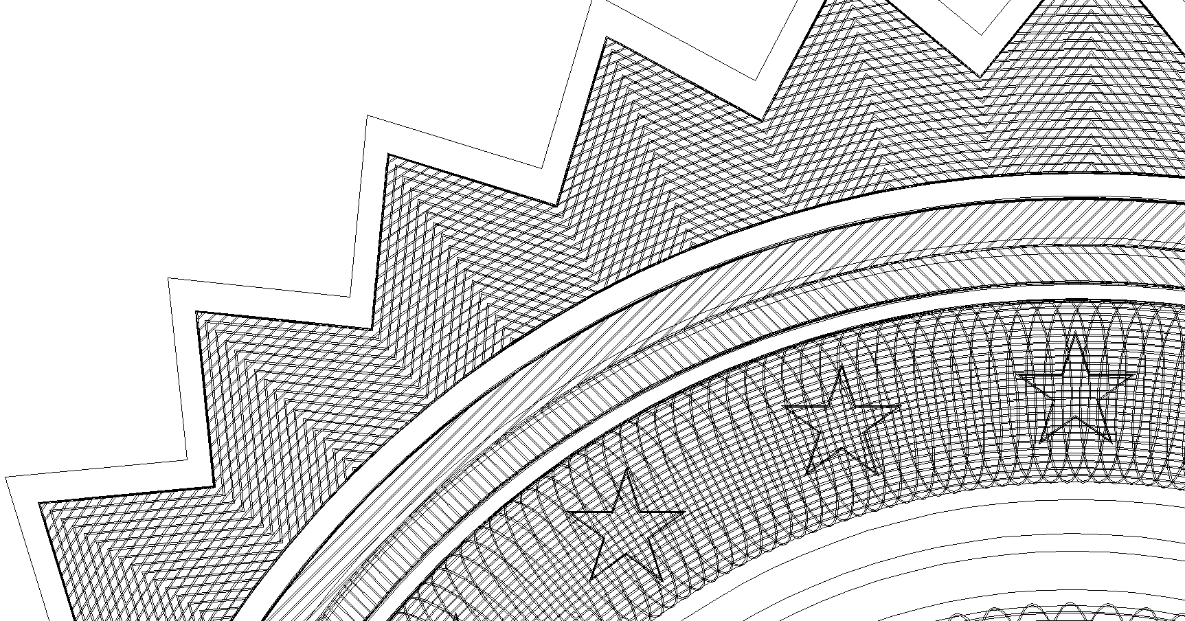

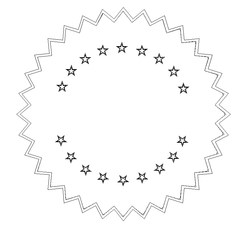

    RositaAuthor
    October 29, 2019
    Hello John,
    Thanks for your help. But unfortunately this does not work.
    The whole artwork gets United, most of the lines are now missing. As seen in the following images.
