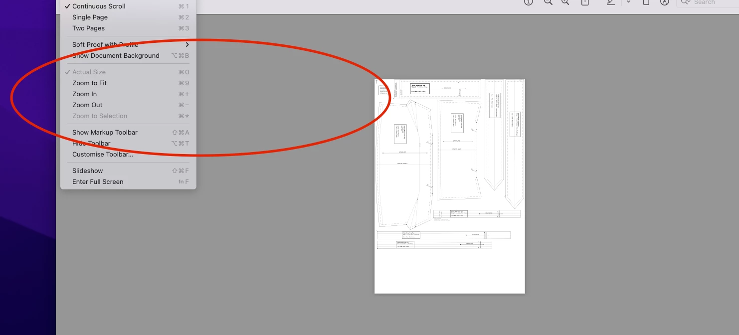

Forgive me as I am very new to illustrator and not very tech savvy. But I have made a file in illustrator a size just under A0 paper size.
When I have converted this into a PDF, and view in actual size in Acrobat reader, it seems correct size.
But when I view it in Mac Preview/ try to print it with my local stationary shop, it's scaled it down 10x smaller.

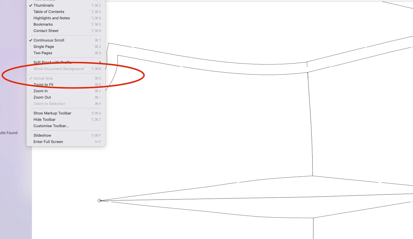

I have another pdf document with a similar size, that when I open it in Mac Preview at actual size, it does show the correct size, so I assume this is something in the way I have saved the file from illustrator and not my preview app.
Thank you
