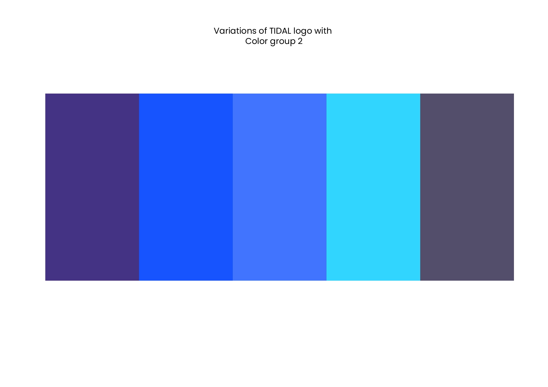

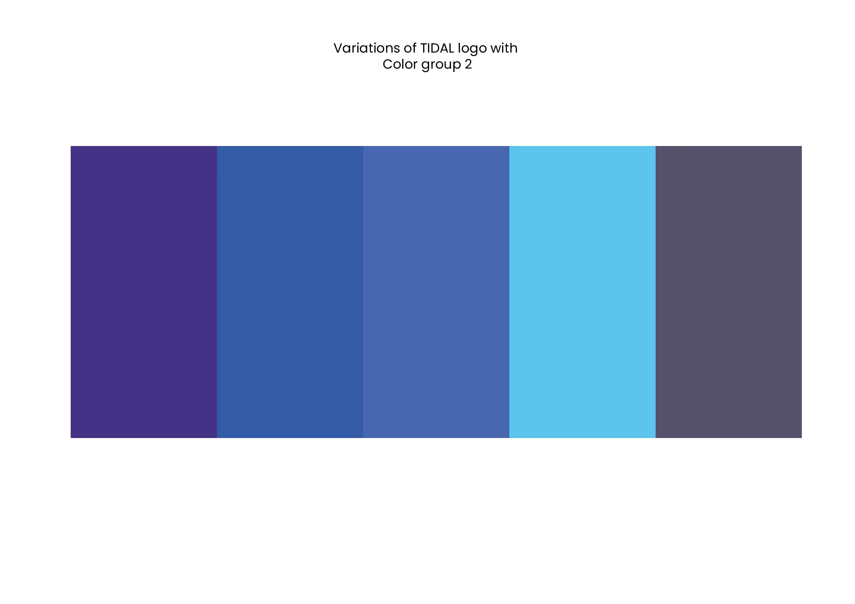

I forgot to set up my document to CMYK colour mode and make some solid shapes with RGB.
When I converted it to CMYK it looks very dull, especially in bright-saturated colours.
Can you give me some advice on how to change to closest possible CMYK colours?

There is a decisive difference in the colour gamuts.
There is no way to create CMYK colours that are that are within the RGB gamut but outside the CMYK gamut. This applies to (some of) the brightest RGB colours.
While it is impossible to get such actual RGB colours in CMYK, you may be able to make acceptable changes to alternative colours that appear less dull/dirty

You can't make those bright colours by any palette, or other trick. It's just impossible to print them with CMYK inks. Do not trust any information about CMYK colours on ANY website, include Adobe's colour palette offering which is shamefully just wrong for CMYK. Trust the gamut warnings in Adobe apps, and the darker colour range you see.
