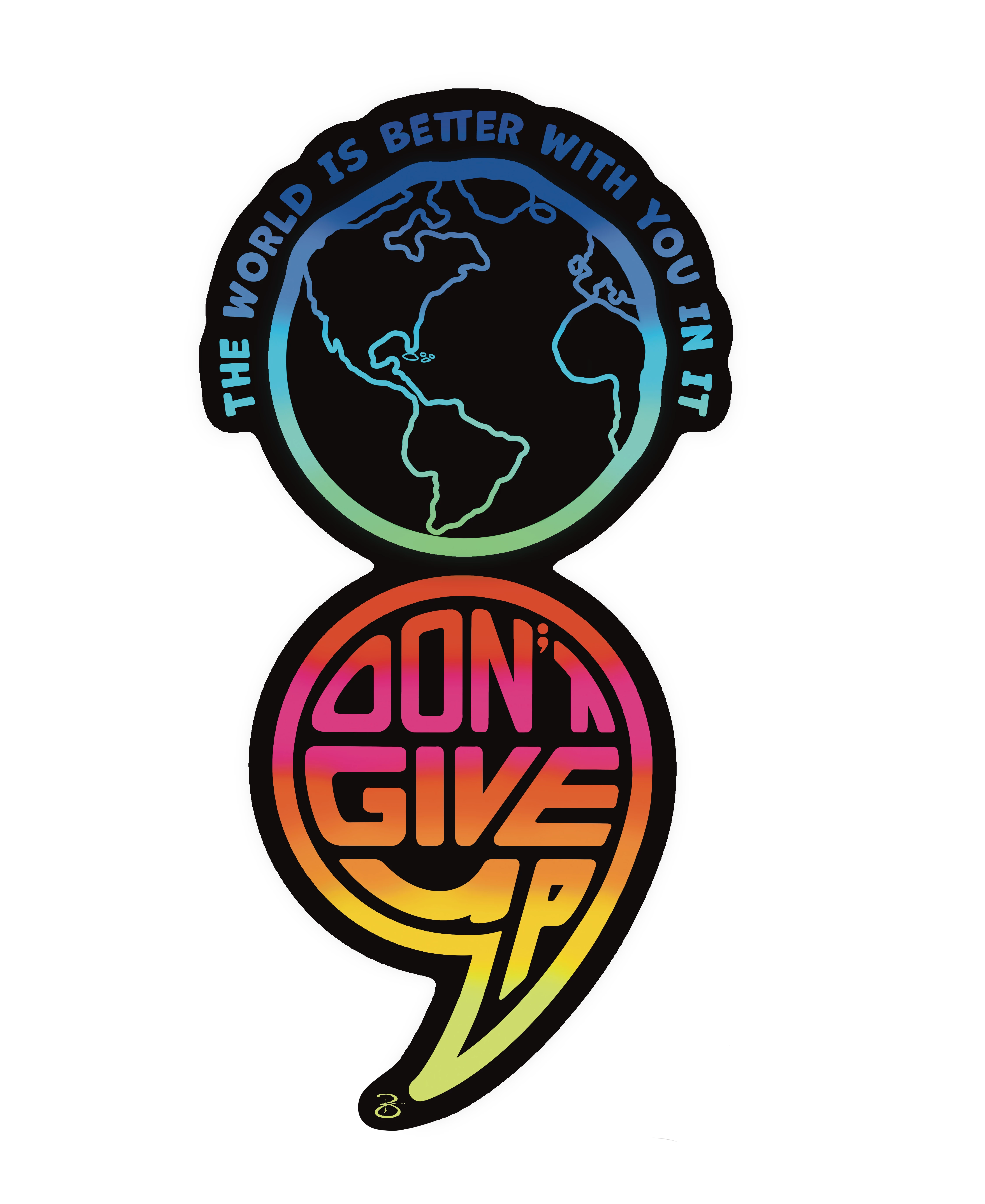

So all of my designs have been done in RGB in Procreate. But now I have people wanting my designs turned into stickers, tshirts and such. Which I have done some already. The sticker company says it has to be in CMYK. So first I created a CMYK canvas in Procreate and imported the image and the colors look absolutely horrible, not even close. Did some digging and found out Procreate's color conversion isn't good and they're working on it for a future update. So then I decided to export it to Illustrator for iPad, which I'm very unfamiliar with using as of now. So I've exported in in various file formats and they all convert the colors equally, but the CMYK does look much better in Illustrator than in Procreate. I'm just wondering if anyone can tell me the best way to do this and get the color accuracy at least as close as CMYK will allow me to as my original RGB? Any other process that's guaranteed for the best results? Any tips on how to color correct it after it has been imported? Also, I need to import it without a background. I shut the background off on procreate before exporting it. It seems that a png file is the only way I've been able to import and there be no background. Is there a reason that it imports with a background when I do it as either PDF or PSD? Anyone out there that can help me out with any of this, it would be greatly appreciated! Thanks!

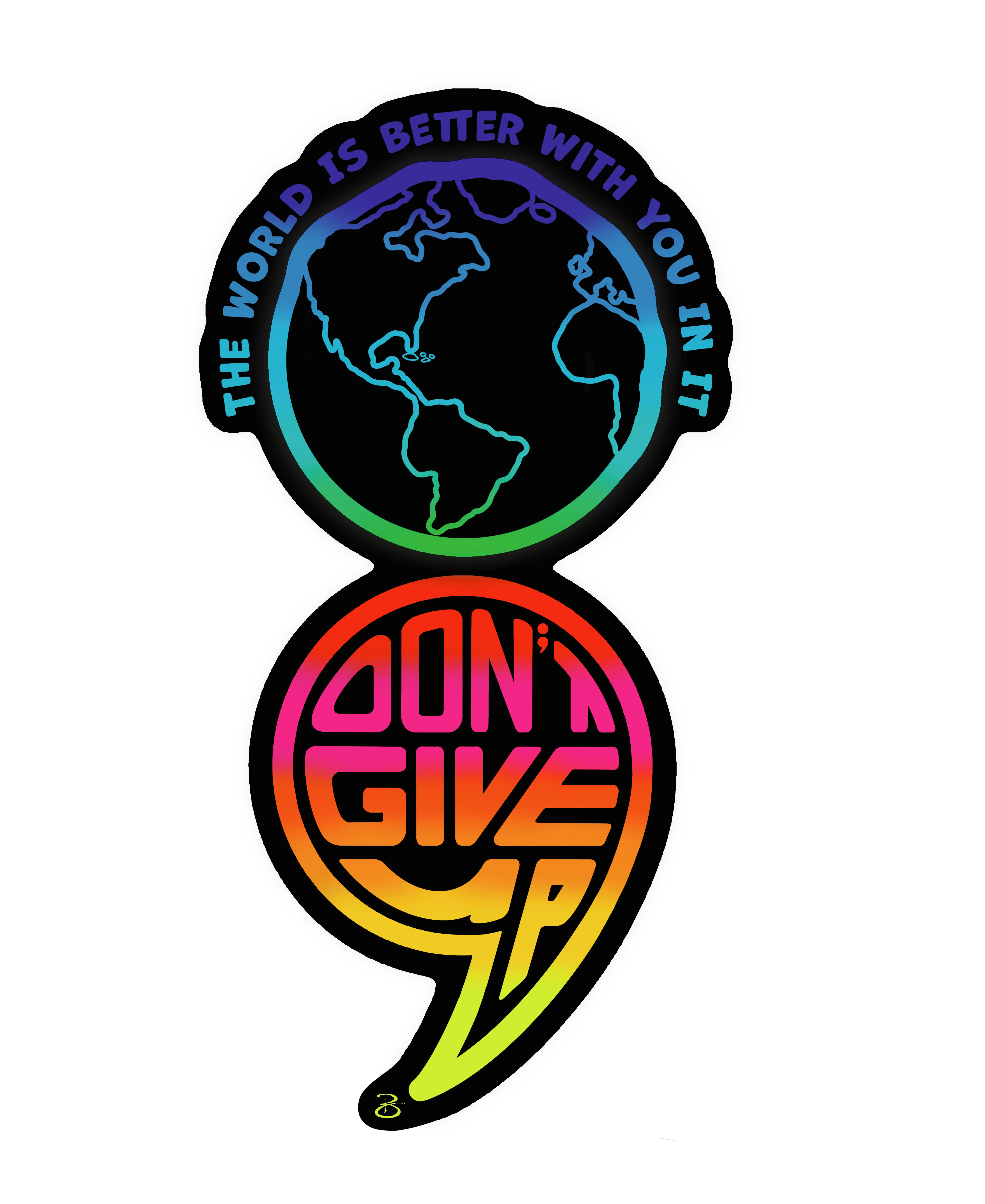

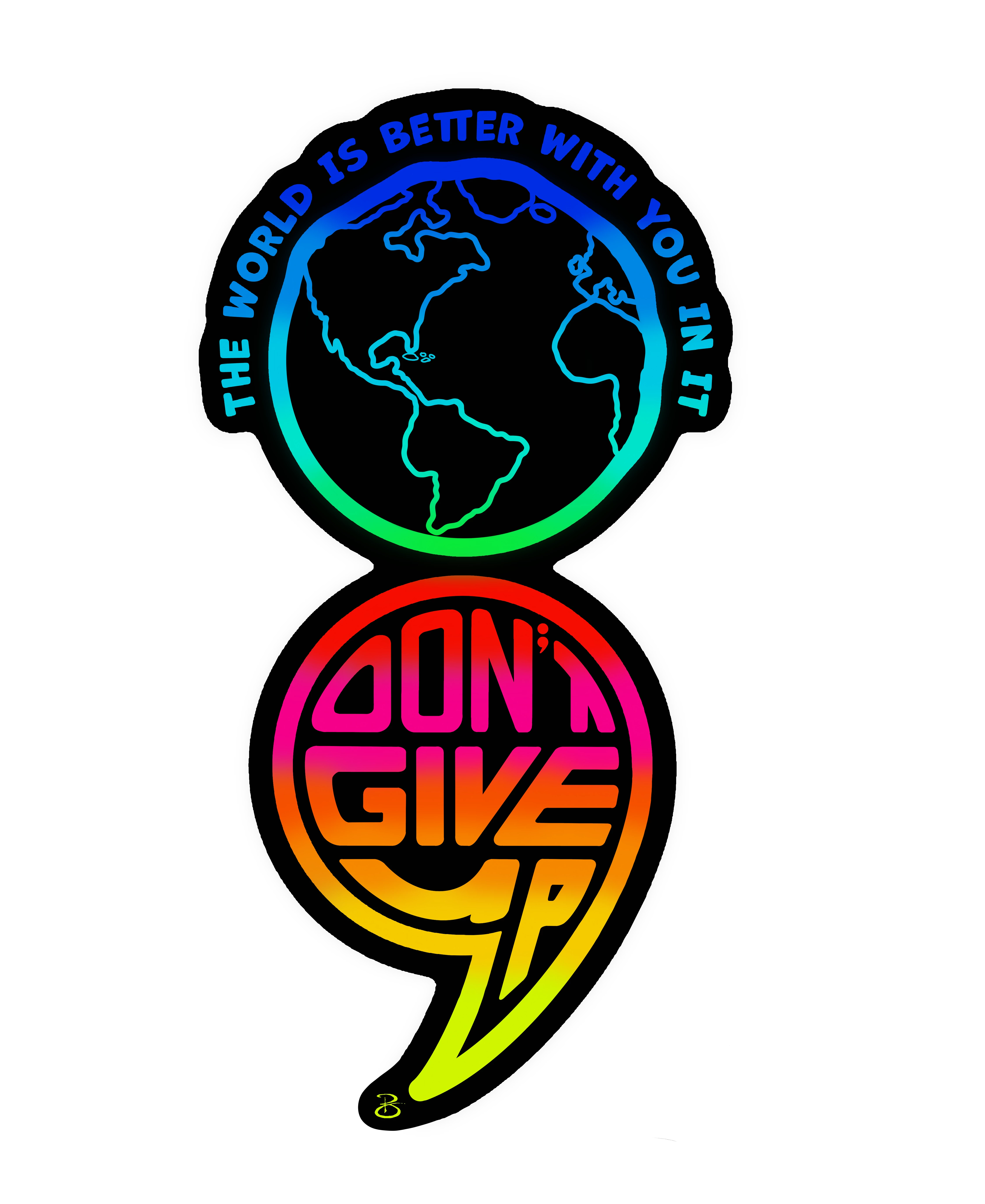

So here's 3 files. The brightest is an RGB from procreate. The dullest one is the CMYK from procreate. And the other is a CMYK from Illustrstor for iPad. Which it's not too bad. The bottom half of the image, the colors seem fairly close with the red, hot pink, orange, yellow. The upper half bothers me. The darker blue at the top is too dark compared to the original and you don't really see the color gradients as much from that to a lighter blue to a teal to a light green to the brighter fluorescent greenish color. I realize they're gonna be duller than RGB, but was hoping to get the colors as close as possible and vibrant as possible. I know I've seen plenty of stickers that have vibrant colors in them. And I'm just not very familiar with Illustrstor. To make any adjustments or know if there any other tricks. And I'm not sure if Illustrstor for iPad would be any different that Illustrstor for desktop or if photoshop could do anything better, but I don't have a desktop computer, just the iPad.

You will continue to have issues with that blue color.
If possible, here's what I would do.
I hope you have the gradient and the black shapes on different layers in Procreate.
Then send only the black shapes to Illustrator (or Photoshop)
Convert the file to CMYK (or just place it into a CMYK file)
Create a new gradient, which will be CMYK from the beginning and adjust it.
