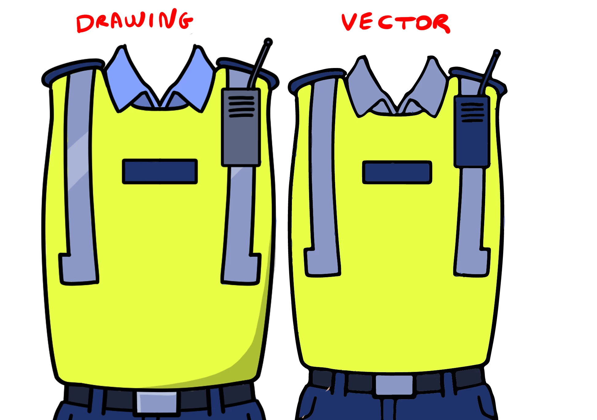

im fairly new to illustrator,  im trying to convert some cartoon characters that i drew (in clip studio paint)
into vector format for animation in after effects. but when i image trace it, the lines come out kinda wobbly, with too many vertices
the original drawings had a line that was same thickness all around , so that it would be smooth and that they would animate well
is there any tool that can make this process quick and painless in illustrator?
in clip studio you have a "simplify line" tool that you can just pass over the line at whatever chosen strength, and it will remove unnecessary vertices and the line will become a lot straighter.  is there any equivalent to this in illustrator?  or a setting that i can get it to recognise that there is a black line there, and it needs to make it straight as possible.

I'm not sure what your two images are showing - they look pretty good if one is pixel and the other the vector image trace to me! Also, what rez does "clip studio paint" export at? (Also, as it has the word clip in it, doesn't it do vector too?).
Anyway, in Image Trace you've got to play with the Advance settings. Use an image that is less complicated to find the sweet spot (so that the refresh on preview is less on each adjustment) and make a note of the settings, then apply to the others.

Ah, you changed the images - I still think that looks pretty good!

You will have an easier time redrawing this in Illustrator than getting a usable file for animation from an image trace.

actually when i choose the "black and white logo" option in image trace, it gives decent enough black lines, problem is you lose all the color, creating another job to do....
