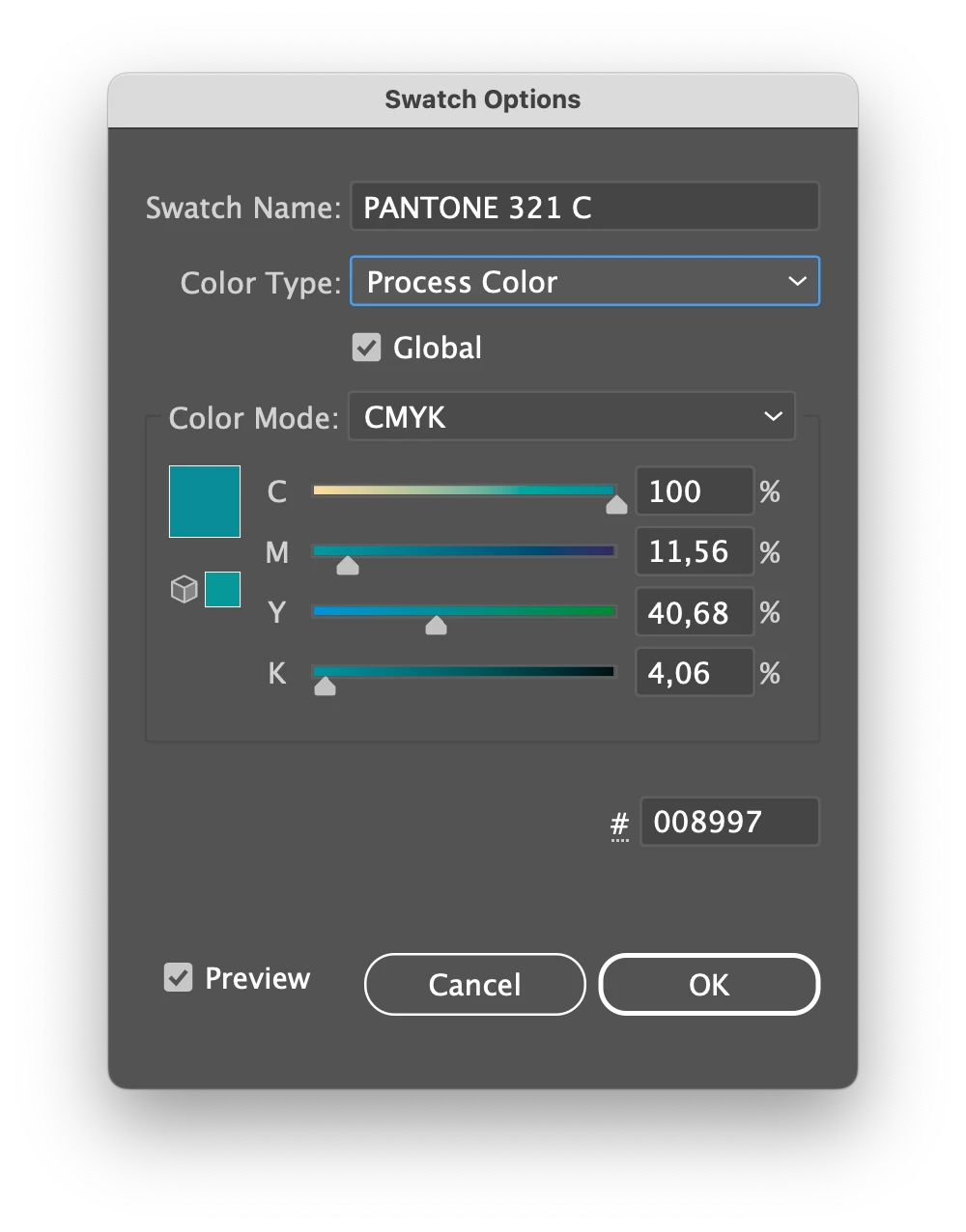

It is not enough to convert Lab to CMYK, you must also set the Color Type from Spot to Process Color.
Monika Gause
February 17, 2024
Like this: https://youtu.be/NjERUGBPcjk
Whether or not this gives an at least halfway correct result depends on correctly set up color management. If you do not print spot colors, then do not use them in your design. Get a printed CMYK color swatch book to select colors.
Sorry for the German interface. What you are seeing is the swatches panel.
