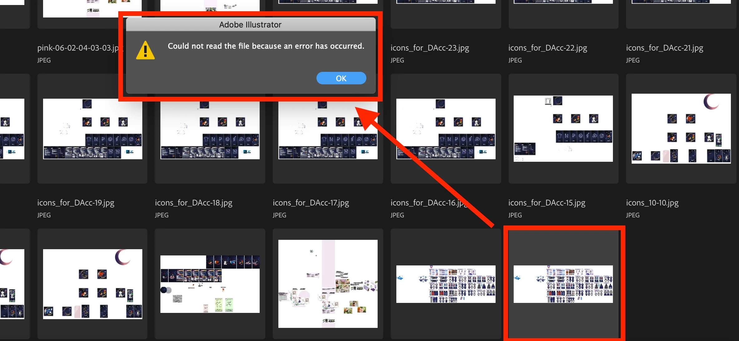

Could not read the file because an error has occurred! What to do with this error?

i could open this file yesterday. Today illustrator showing error. Help, please!
    Correct answer ruangrit19@gmail.com
    Mac : System Preferences > Security&Privacy > Privacy >Click unlock > Full Disk Access > Click + > Adobe illustrator

    Instead of allowing full disk access, I went to "Files and Folders" and checked the 2 options listed below "Adobe Illustrator 2020". See image below
