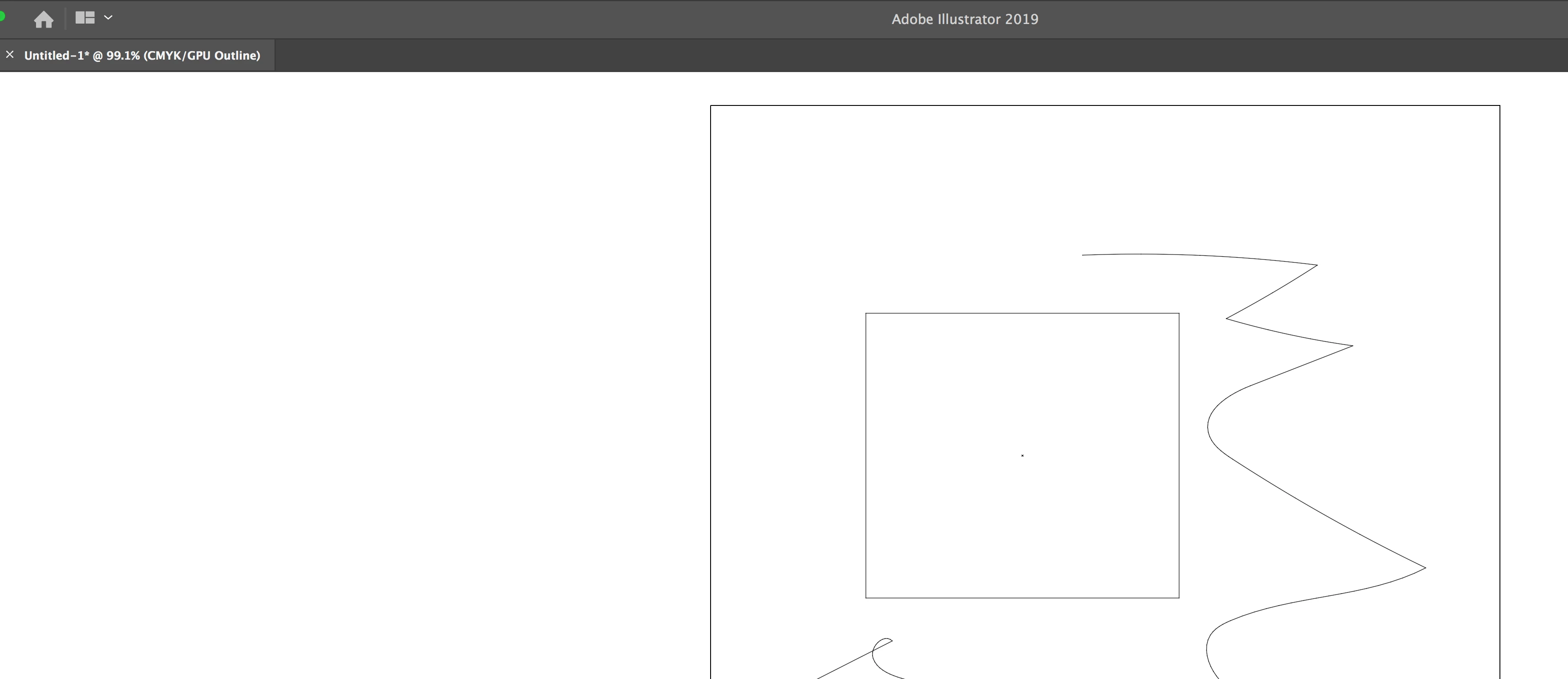

Working on Illustrator cc 23.0.3, when GPU is checked in prefs it is an option but if you move from outline to either 'CPU' or 'GPU' nothing happens. To get back to any preview its 'preview' only. Is this right? Is it important?
I have two macs 2105 27inch and new bought two weeks ago and both acting same way.
Thank you in advance and apologies if this is not worth worrying about!

    I can reproduce that behaviour and it has changed in CC 2019 compared to previous versions.
    Cmd Y (Ctrl Y on Windows) still switches between Preview an Outline.
    In previous versions the Outline mode view did not use the accellerated GPU.
    In 2019 it does, so you stay in outline mode, but you can use the accelerated preview for outlines.

    Just been on to Adobe for the last few hours... They dont understand why the 'command E' and drop down menu option for GPU/CPU doesnt work. First they tell me it does work but it doesnt do anything when clicked, other than give me an outline view in GPU or CPU. They are escalating the bug! It is the same on both my 2015 and brand new mac, so its not high sierra/mojave problem. All other previews work...
    We will see...

    Tried toggling - no change - tried trashing prefs - no change - this is happening on both machines.
    If in outline mode the only option to get back to colour is "preview" - however by clicking 'GPU' the file says GPU outline.
