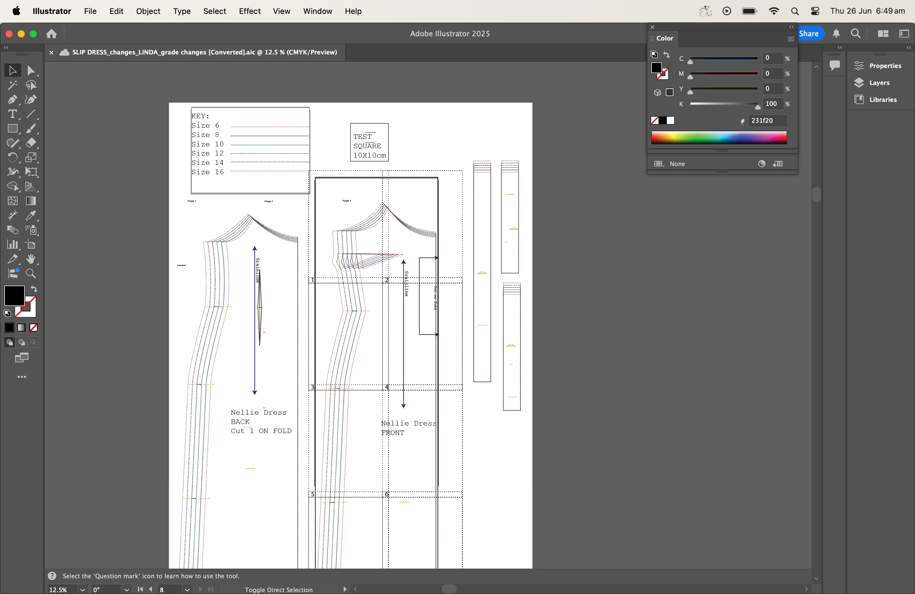

Create a border on each A4 page from a large file - Dress making pattern
hi,  Im creating an A4 pdf dress pattern, that will go over many A4 pages. I know how to print and tile etc, however, i need each A4 page to have a 1.5 cm border. Can you please advise how to do this?
Thanks, Georgie
georgie_7126Correct answer

Ton Frederiks
June 25, 2025
Give the artboards a negative spacing of -15mm to have them overlap. Like this:

hi Tom, thanks, this sounds good. Can you tell me how to do it?
You have created 72 artboards right?  I have a few, see below. I will do some research on how to convert this to the required number of A4 pages, and represented as Artboards.

Ton Frederiks
June 25, 2025
Does this border have to be added to the A4 page or has the boarder fall within the A4?
If it has to fall within, you may be able to use multiple 180 x 267 mm artboards with a 15 mm bleed and 0 mm spacing.

hi @Ton Frederiks , I got there in the end. It worked when I created the document on the "Print" tab. I used normal A4 dimensions and then created the document with -30 spacing and 0 bleed I believe. It's working great now!  Problem solved. Thanks so much for your assistance, you really helped me get on the right page.  Wishing you all the best. CHeers,Georgie

Monika Gause
June 25, 2025
And entering 15 mm for the overlap does not work?
June 25, 2025
hi Monika, thanks for ur reply. No, it doesn't work, and not only that. There is 1.5 cm border at all...Im still stuck on it. See screenies.  =0 )
