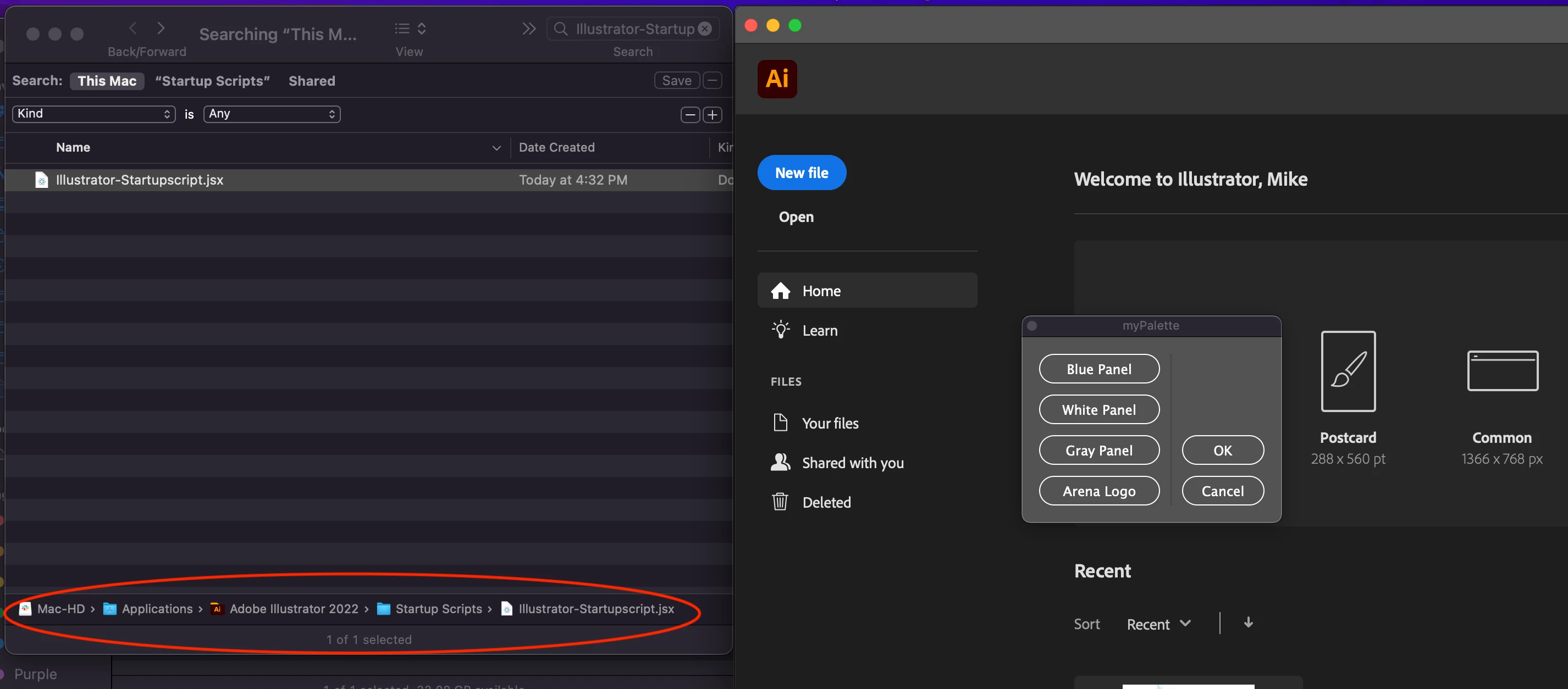

I put the script in the location shown in the screen shot and the palette window opens when Illustrator is started, just leave the palette window open while you work.

You should be able to create/save the script as a "startup" script where the palette window will open automatically and will remain open while you work.

femkeblanco
October 26, 2022
See if this works.  An item needs to be selected.
#target Illustrator
#targetengine main
// palette
function SimplePalette(){
var palette = new Window("palette");
    palette.text = "myPalette";
    palette.orientation = "row";
    palette.alignChildren = ["left","bottom"];
    palette.spacing = 9;
    palette.margins = 16;
// GROUP1
var group1 = palette.add("group", undefined, {name: "group1"});
    group1.orientation = "column";
    group1.alignChildren = ["left","center"];
    group1.spacing = 10;
    group1.margins = 0;
var button1 = group1.add("button", undefined, undefined, {name: "button1"});
    button1.text = "Blue Panel";
    button1.preferredSize.width = 110;
    button1.onClick = function bluePanel(){
		//Resize the Blue Panel
        var BT = new BridgeTalk;
        BT.target = "illustrator";
        var script = "app.selection[0].width = app.activeDocument.width;\n" +
        "app.selection[0].height = Math.sqrt(app.activeDocument.width * app.activeDocument.height) * 0.08;";
        BT.body = script;
        BT.send();
var button2 = group1.add("button", undefined, undefined, {name: "button2"});
    button2.text = "White Panel";
    button2.preferredSize.width = 110;
    button2.onClick = function whitePanel(){
		//Resize the White Panel
        "app.selection[0].height = (Math.sqrt(app.activeDocument.width * app.activeDocument.height) * 0.08) * 1.5;";
        BT.body = script;
        BT.send();
var button3 = group1.add("button", undefined, undefined, {name: "button3"});
    button3.text = "Gray Panel";
    button3.preferredSize.width = 110;
    button3.onClick = function grayPanel(){
		//Resize the Gray Panel
        "app.selection[0].height = (Math.sqrt(app.activeDocument.width * app.activeDocument.height) * 0.08) / 3;";
        BT.body = script;
        BT.send();
var button4 = group1.add("button", undefined, undefined, {name: "button4"});
    button4.text = "Arena Logo";
    button4.preferredSize.width = 110;
    button4.onClick = function arenaLogo(){
		//Resize the Arena logo frame
        var script = "app.selection[0].width = (app.activeDocument.width * 30) / 100;\n" +
        "app.selection[0].height = (app.activeDocument.height * 5) / 100;";
        BT.body = script;
        BT.send();
// palette
var divider1 = palette.add("panel", undefined, undefined, {name: "divider1"});
    divider1.alignment = "fill";
// GROUP2
var group2 = palette.add("group", undefined, {name: "group2"});
    group2.orientation = "column";
    group2.alignChildren = ["center","bottom"];
    group2.spacing = 10;
    group2.margins = 0;
var ok = group2.add("button", undefined, undefined, {name: "ok"});
    ok.text = "OK";
    ok.preferredSize.width = 75;
    ok.onClick = function () {palette.close()};
// var cancel = group2.add("button", undefined, undefined, {name: "cancel"});
//     cancel.text = "Cancel";
//     cancel.preferredSize.width = 75;
palette.show();
SimplePalette();
