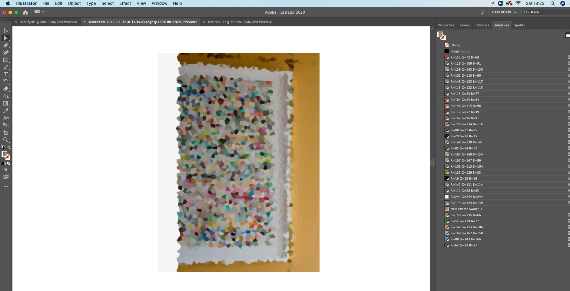

Harvo09Author
June 6, 2020
Thanks for the answer so far, this link seems to be able to do it in an older version...
http://carijansen.com/tip_093/

Harvo09Author
June 6, 2020
Thanks Ares,
I actually started doing this. But the image is still and image and won't do as you say..This is me doing it manually.
