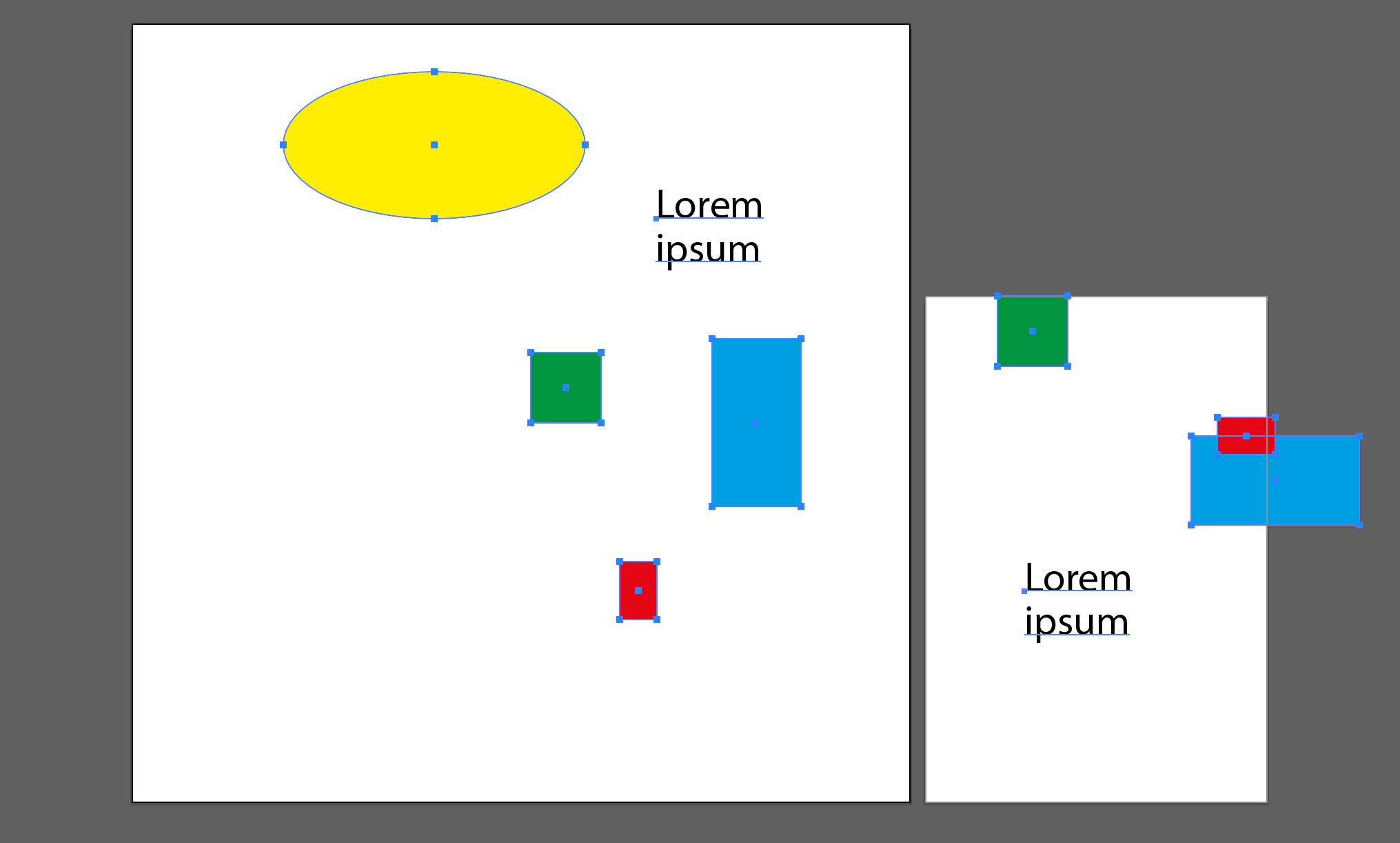

create script to move on the Y axis using artborad as a reference
I can't create a java script to align all objects to the base of the artboard because it always gives an error on the Y axis. I've tried several approaches but so far nothing
Does anyone have an example script how to align multiple objects to the base?
on the x axis it works perfectly to center without losing the relative distance between the objects, however I have not had success in relation to the Y axis, either to measure the size of the grouping, to center or to move

Hi @Luiz Vigraf there are some complexities to this issue, for example: getting the actual bounds of an item is difficult in many cases, such as text or clipping masked items. I have written a function to help with this (see in script below), which makes things much easier, and made writing this script today super quick. I also wrote a function to get the most likely artboard for a given page item, which will be handy, too. I included an option for left justifying the items (you might not need this, but I did it for fun—turn it off by editing `settings.justifyLeft` to false in the script.
Let me know if it's useful.
- Mark
