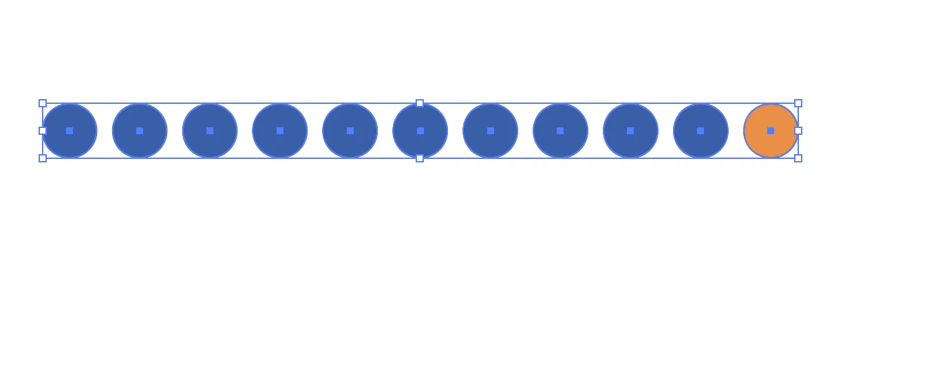

I'm trying to recreate a dotted line much like the one here. Basically I am trying to get every 5th dot to be a different color.

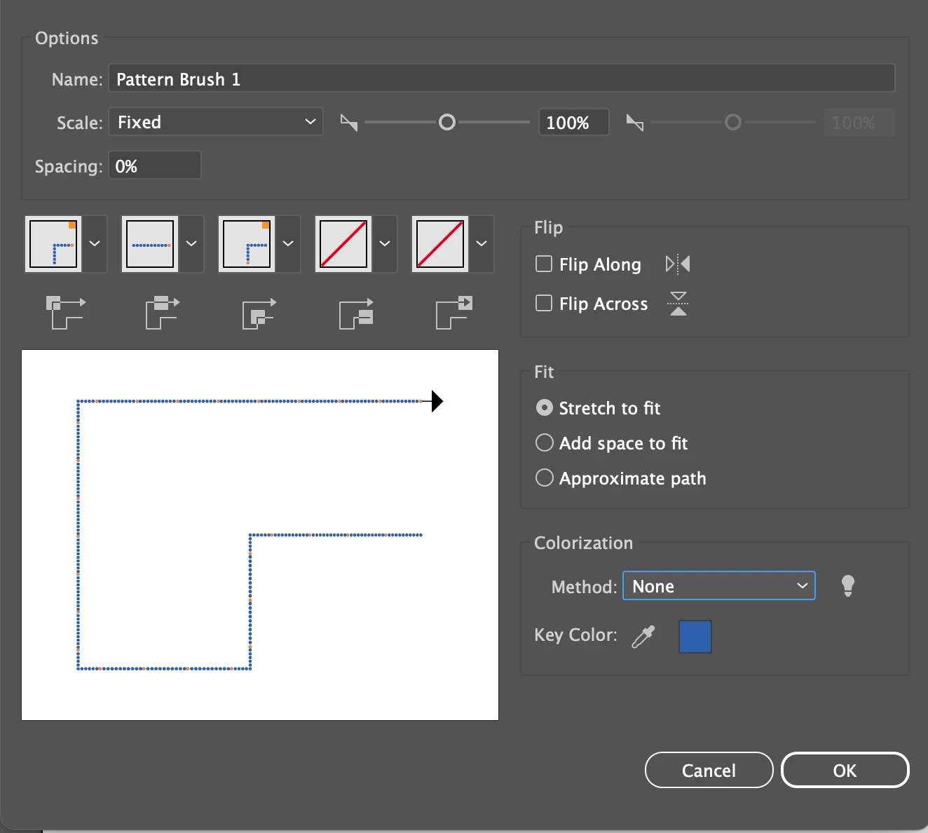

I tried to create it by making my own brush but then the dots just begin to warp. See below. Any tips on getting a uniform, not warped dotted line brush to work?
This is the pattern I want to work from.
tried to make it a brush here, seems like it would work.
and then things like this happen.
 (dots aren't perfect circles anymore)
I also tried to make a simple dotted line brush wihtout changing colors, but even if I want to expand the line and go in and change every 5th dot myself, I cannot singularly select the dot I want to change the color to.

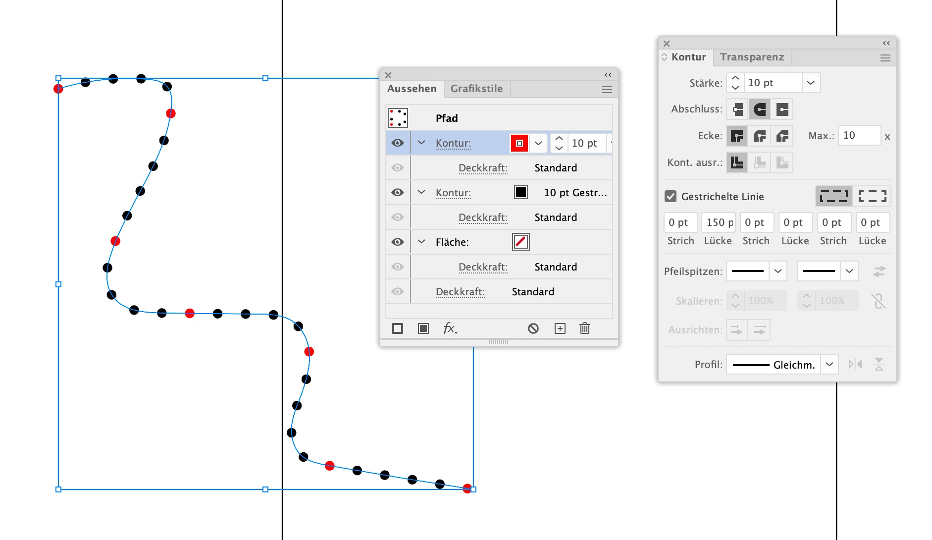

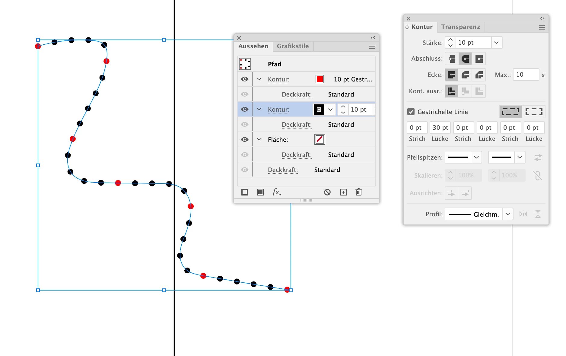

May 4, 2023
Use the Appearance panel with 2 strokes
