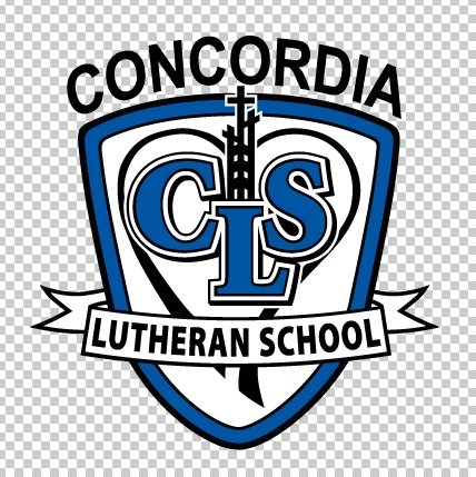

Creating a die line with fill.
I have tested some other options from searching and not getting the results that I needing.   On the image I need to create a fill behind the entire image that is the same shape as the design, but increase the size to create a cut line.
The options that I have tried are putting a path behind the Concordia text in the shape of the letters instead.  I am certain that I have not explained this very well.

This is a vector image, right?
And you need this as a cutline, and it doesn't need to be editable?
In that case:
duplicate the layer. Lock the original
In the duplicate outline all the fonts. Outline all the strokes. Expand effects (if any)
Select all and use Unite from the Pathfinder panel (top left button)
Then apply Effect > Path > Offset path to that.
Make it so large that all the gaps are closed.
Object > Expand Appearance
Apply Effect > Path > Offset path again. This time a negative value, Make rounded corners. And adjust to the size you need
When done, Expand Appearance again

ericm10089679
Sep 3, 2024 12:18 PM UTC
Thank you. I stopped one step short.  Thank you for the help, will be saving this for future use!

Is everything on the same layer?
If so, then activate the layer and then open the Appearance panel and add a new contour there. Give this contour the effect: Offset Path.
