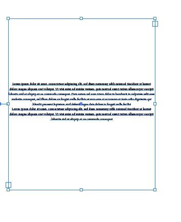

I want to align the textframe contents the same as above using a script.

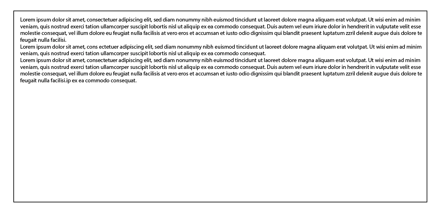

Hi @SA8888, I looked into it and unfortunately the vertical alignment setting is not exposed via the scripting API.
As a poor substitute, you could try something like this script, which vertically centers the text simply by moving the whole textFrame up or down. Try it out to see what I mean.
- Mark

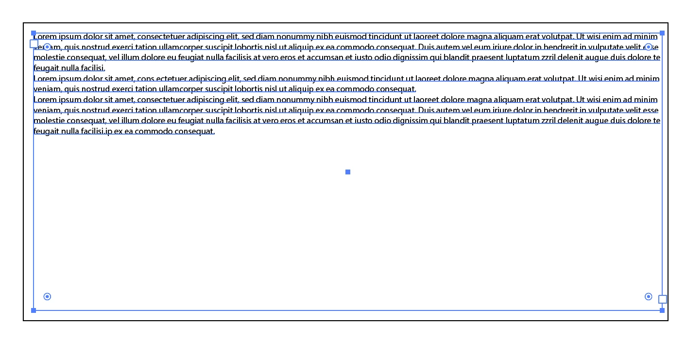

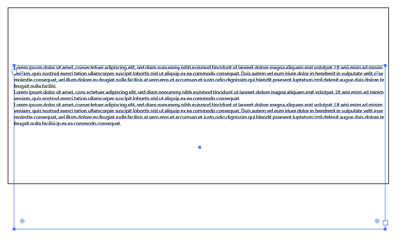

Here are screenshots showing what it does. The black keyline around it is just for visual reference.

Hi, @m1b thankyou for the script. I'm trying to place the contents vertically aligned inside a text frame, not on the whole page.
Like the screenshot below, I have used AreaType Option --> align vertical --> center. I wanted to try this same using the script
