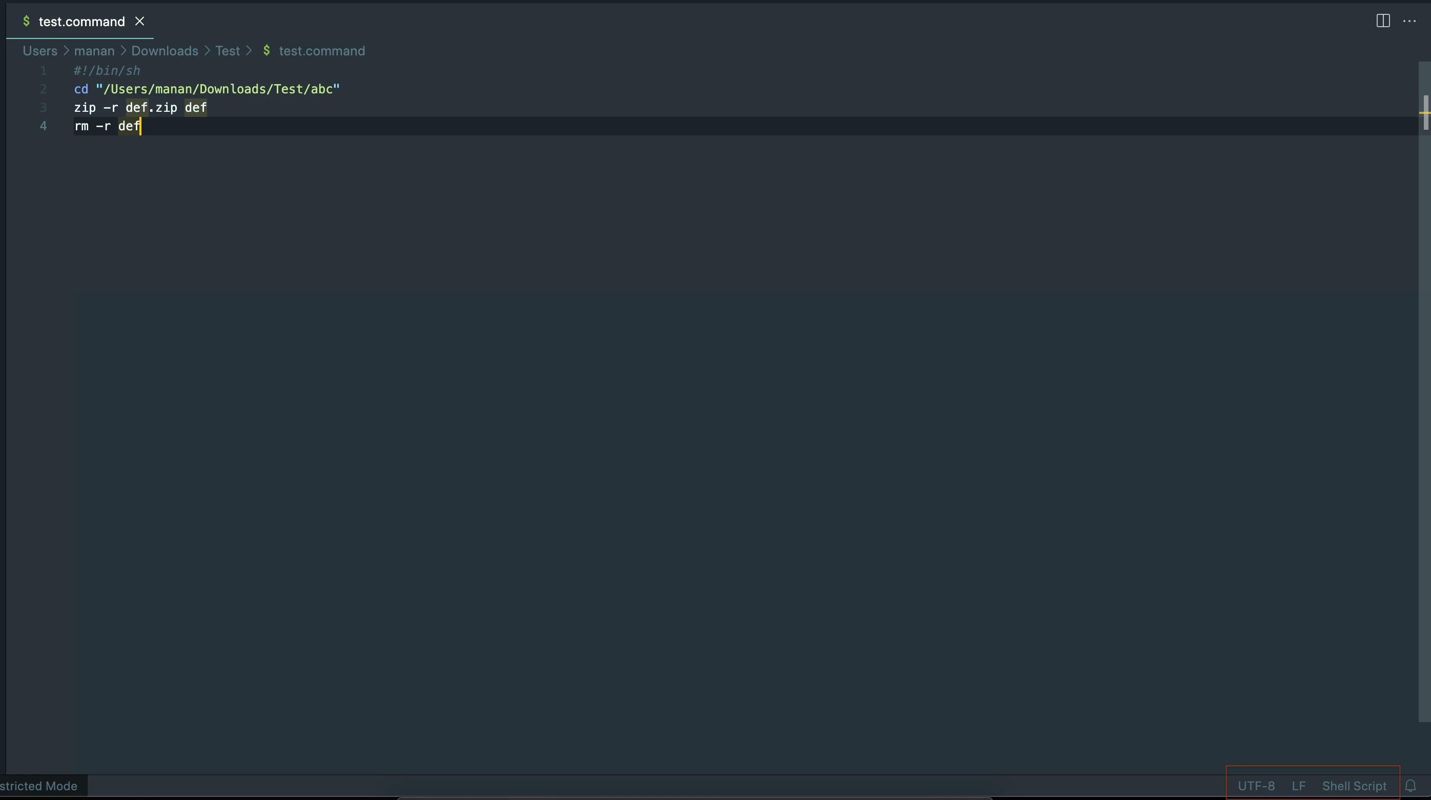

I am sharing a screenshot of how my command file looks with regards to linefeed when I open it in VSCode.

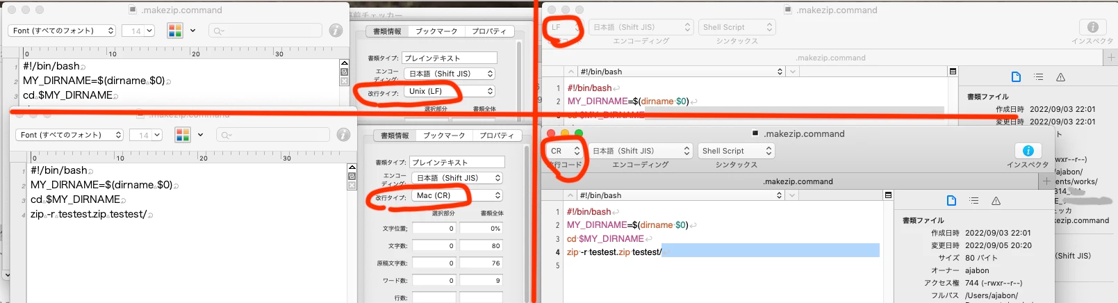

I tried opening the file in two different editors, both with CR...
The upper one is before and the lower one is after.
My OS environment is Mojave (10.14.6).
