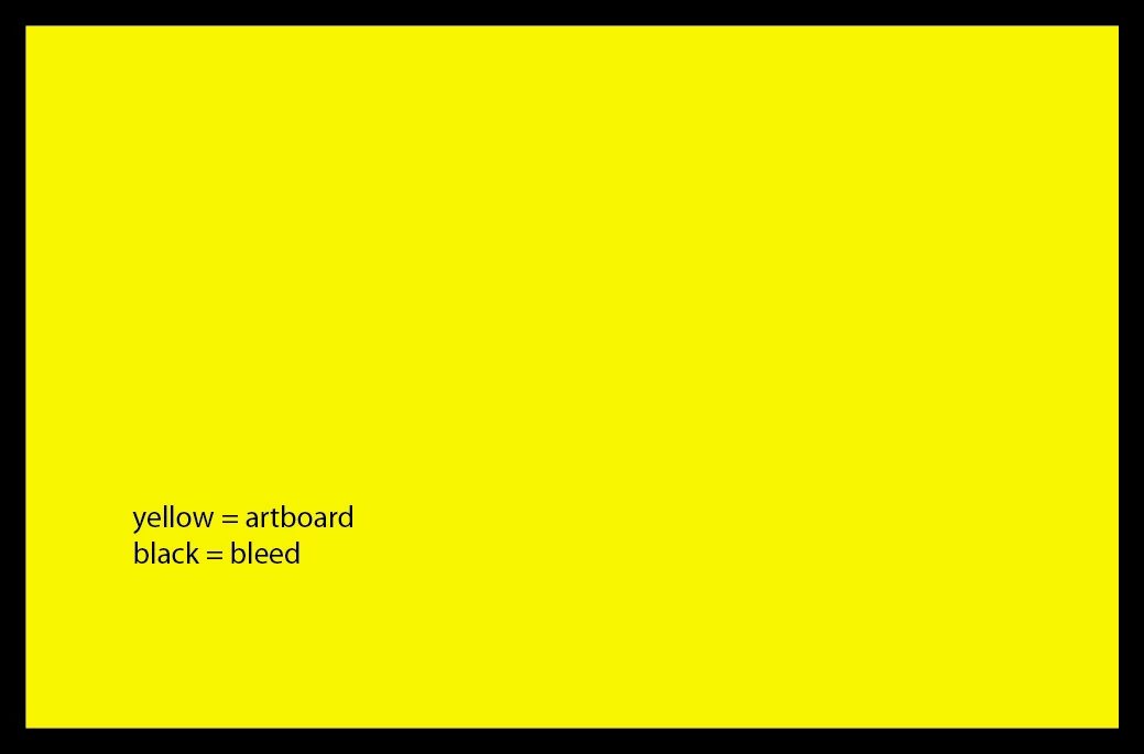

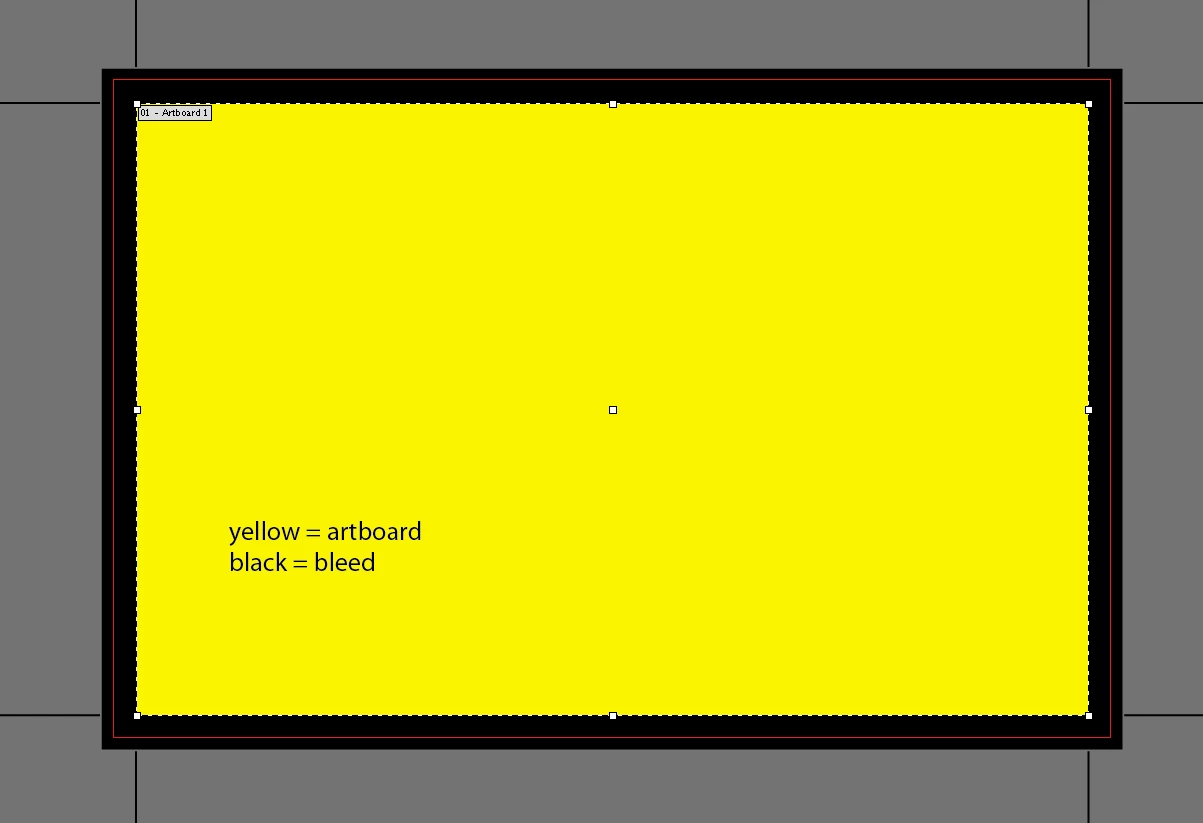

    Got some screenshots, check this out.
    So I want to export to jpg only that part of art which is inside artboard. I have bleeds set up for print but I don't want them on my jpg previews - I thought that's the way artboards works, am I right?

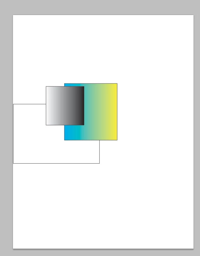

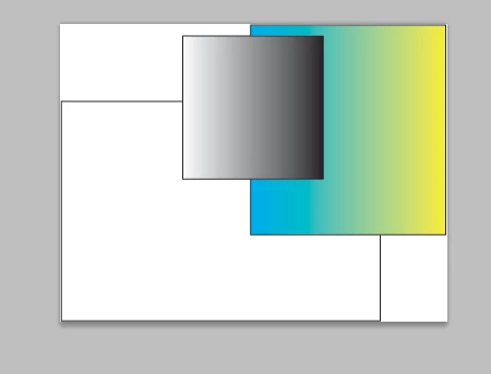

    If I use art boards I do not see this in CS 5 if I do not use artboards it does leave a small extra space on two sides both I belive have something to do with rasterization of the file.
    zthis is using artboards and that is the full artboard nothing more.
    this is without using arboards
    It only shows a bleed if you have one.
