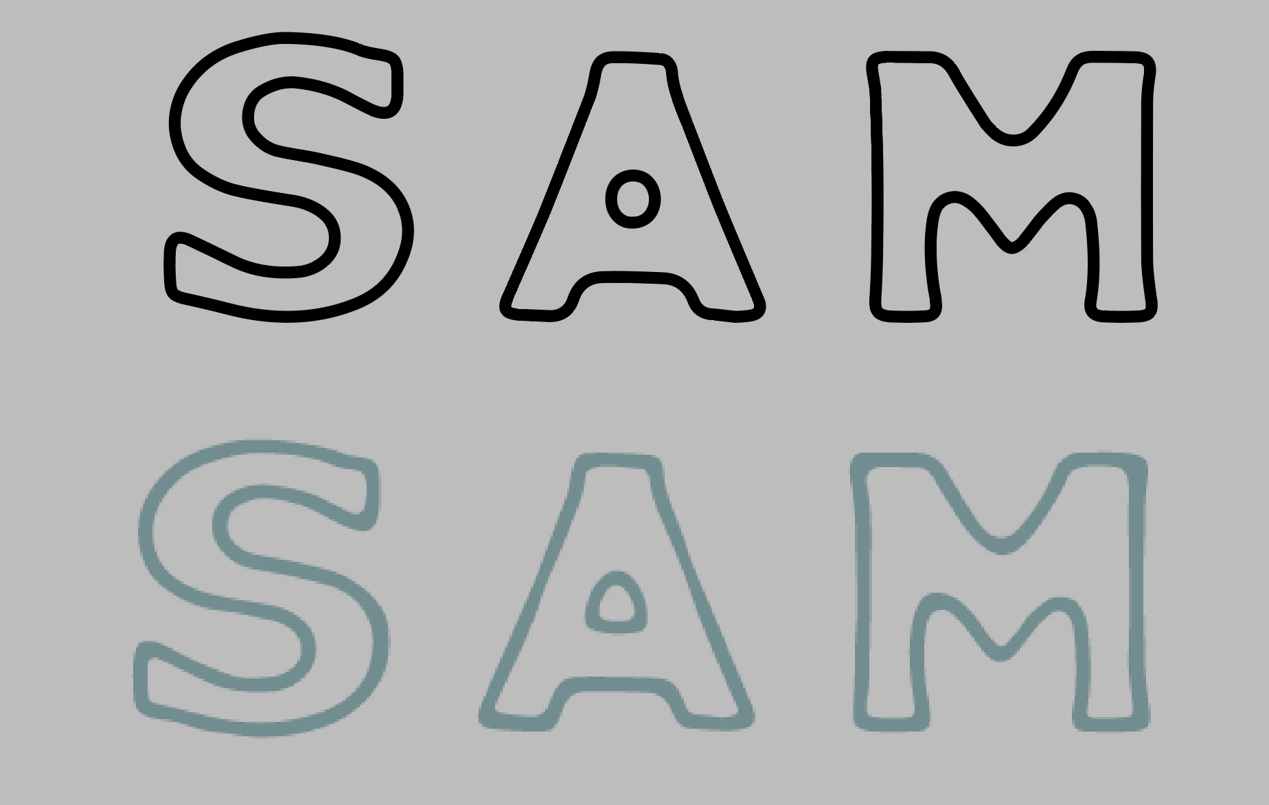

Hi yall,
I'd like to make the black stroke look like the screenshotted stroke in blue underneath. The difference is subtle, but the internal corners are softer and the line weight varies slightly around the letter, not sure how to achieve this??
Not sure if its done as a stroke or after expanding, but I've tried Distort/Roughen and different brushes and its not looking right, any help appreciated thanks!!

Is there a way of getting that style without using a brush or the roughen setting? Is there any other tool or technique in illustrator that could get that outcome without then handrawing?
Thank you so much for your help!!
Brush
Outline & Roughen effect
Width tool
Plugins (stute Graphics, not free)
Those are your options.

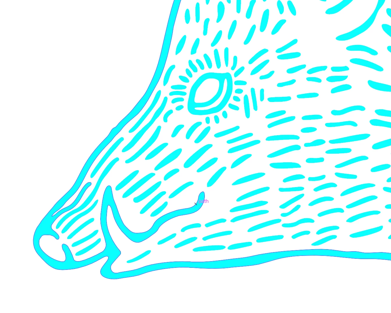

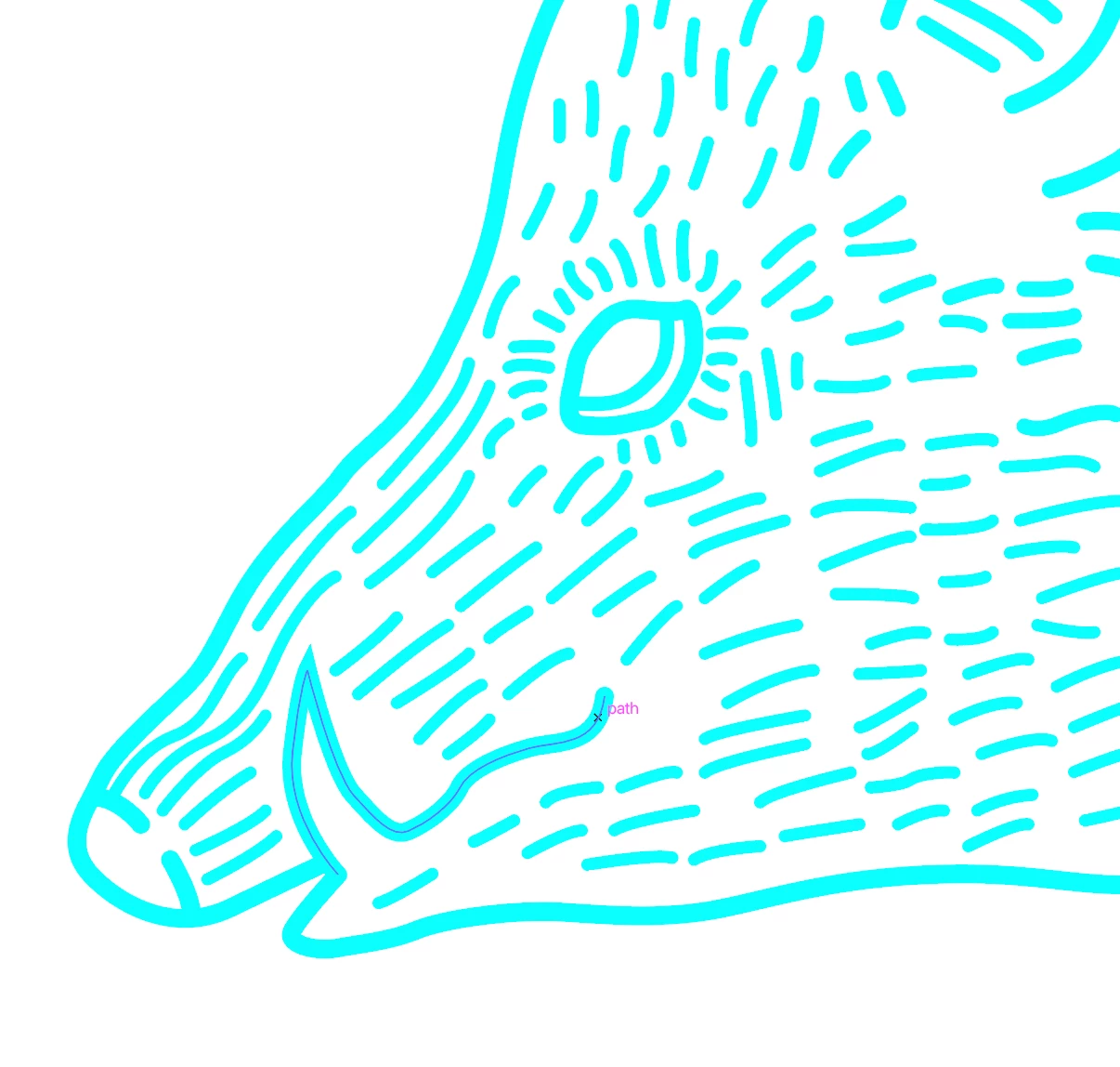

Attatched are some exapmles of what I think are the same technique, the path drawing and compound path drawing are identical apart from style (so i imagine the path drawing was done first and then expanded) do you think theres a way to edit drawings like this overall? or was this done line by line?
