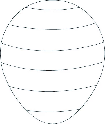

Hey there. Can someone please help me with how to cut apart a striped ball or balloon shape into separate shapes.  I've attached a sample file.  This is being sent to a laser cutter and I need to adjust for kerf, so I need the 7 curved shapes to be on their own.  I can't use the knife tool to create this because I need the curves the way I need them, not my wonky knife curve, so I had to create it with the outside balloon shape then put in the curved lines.  Is my only option to copy and paste the curved lines on top of each other, then cut the balloon wall where they intersect, join the paths, then do the same for the next shape down?

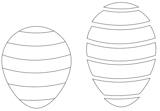

Is this the sort of thing you're looking for?
Select it all and click inside each segment with the Shape Builder Tool. Don't drag through them, or it'll just join them all.

Pathfinder > Divide ?

Thank you, but the first answer was perfect.  Just what I needed.

Oh my!  That is EXACTLY what I needed!  I have been searching for days and have not found this answer.  Thank you thank you thank you!
