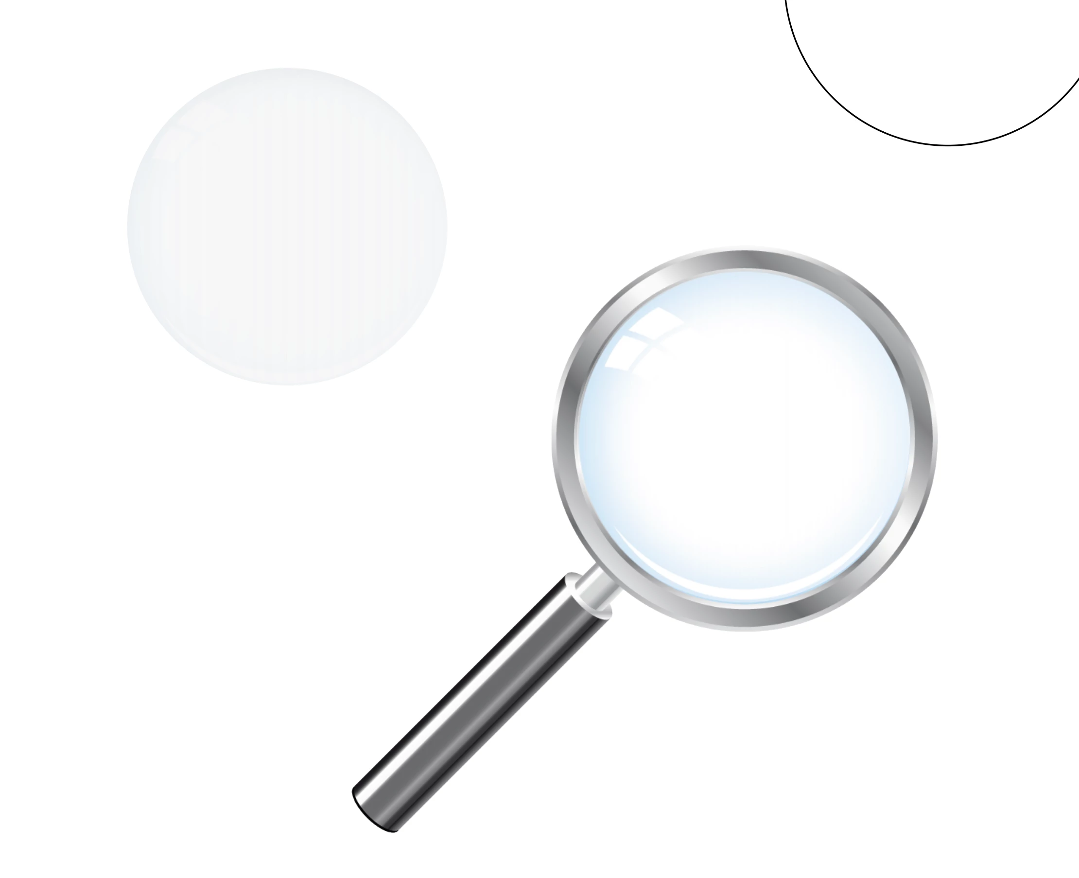

I have a magnifying glass - I need to be able to lower the opacity of JUST the glass (so I can more clearly see what will be underneath), without affecting the opacity of the handle.  I thought they would need to be 2 separate items to do this. I would also be happy if i could select the glass alone, and lower the opacity - is that even possible?
Started in InDesign, and somehow managed to remove the glass - but couldn't find any way to "keep" the handle as well (see upload: "InDesign workings" where the glass is separate on left, but handle still has glass inside). You seem to only be able to keep what's INSIDE a shape. Not the inverse?

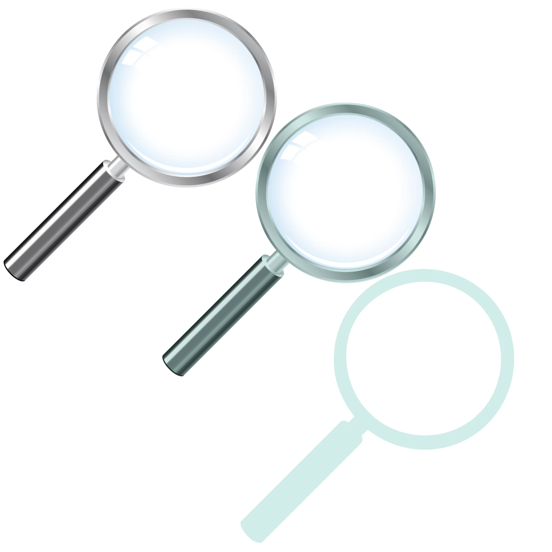

So I moved over to Illustrator, and made a mask - thinking I could cut the glass out, and move it aside so that I would have two pieces - handle and glass ("Illustrator workings" upload shows original magnifying glass (upper left), magnifying glass with mask on top (middle), and the mask on it's own (lower right).

Illustrator process: https://youtu.be/rlArZk54yzc
InDesign process: https://youtu.be/pqX9Y82p698
If you want to have it semi-transparent, then you can also set higher values than 0%
