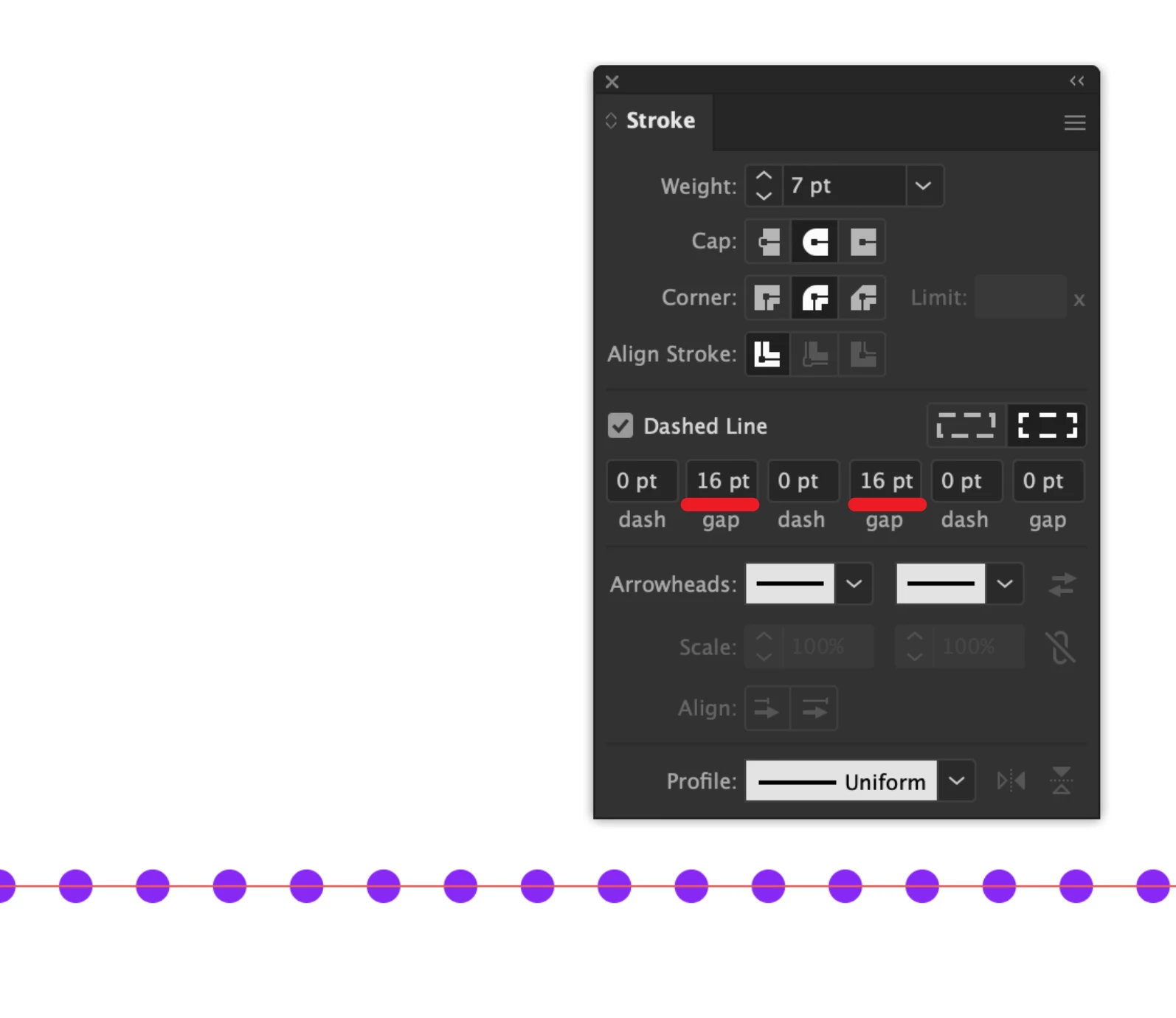

Hello!
I have the same issue, whenever I enter a gap value and then click somewhere else the line goes back to being a straight non-dashed line with the values I just entered deleted.
I've had this problem under Mojave with an older AI version on a Macbook and I have it now with the newest CC version on a new iMac with Catalina. With some updates the problem disappeared but the returned with another update. Reinstalling Illustrator didn't fix it.
But I did find a workaround: If you enter the values not just in the first gap field but also in the other one, it should work.
Hope I could help a little!

July 25, 2023
Hello Danny!
Commenting to say that your workaround worked! Thank you!

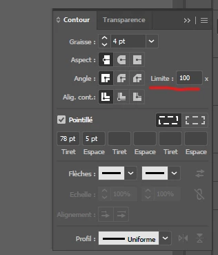

Hi, Try to change the limit of the angle to a higher value.
