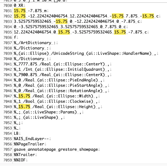

Hello, StewartPDaso.
Illustrator files are described in terms of points.
0.21875in = 15.75pt, so I don't think rounding is happening.
When I open the file in my text editor, it's 15.75.
For the number of decimal places, it appears to describe up to the 12th digit.
However, I don't know if Illustrator is able to draw the screen as described in the file.
