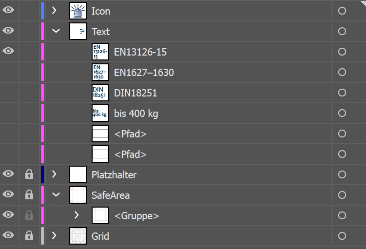

Hi, I need help with a small issue. I tried several delete hidden layer scripts I found but none of them worked.
I wan to delete the hidden layers in Layer "Text" before I export the file.
I am using this to make changes to the layers beforehand:
if (bks.layers.getByName("Text")){
bks.layers.getByName("Text").locked = false;
var text = bks.layers.getByName("Text");

As explained by pixxxel_schubser  Text layer do not have sublayers, Text  layer have pageItems inside that and that can be either textframes, file, rectangle, path or any other object. If you want to delete hidden items from layer "Text" try following snippet
var layer = app.activeDocument.layers.getByName('Text');
var pageItems = layer.pageItems;
for (var i = pageItems.length - 1; i >= 0; i--) {
  if (pageItems[i].hidden)
    pageItems[i].remove();
Let us know if this works for you.

June 15, 2020
it worked when exporting the eps and svg files but not with the ai files. Any idea?
Kind regards,
Elli
Charu Rajput
June 15, 2020
Well, this is not something related to format of the file. Could you please share the screenshot of Layers panel when ai file is open or share the ai file in which it is not working. There must be something how you have created items in ai files.
Best regards

Hi @ellipirelli,
it seems you don't have sublayers in your layer "Text" - but text frame items and path items instead.
