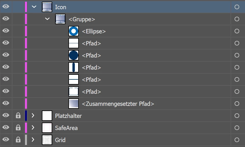

I need to delete the last layer in a group or delete a CompoundPath layer that is part of a group. Or delete a layer of a group that has a certain name. I think I need to loop through the function but I am not sure how.
These are my layers:
The amount of layers can vary...
Here iy my script:

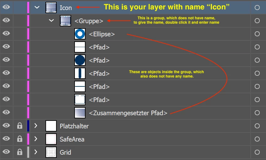

First of all you need to correct your terminology here. For an example, you said "last layer in a group". Well layer cannot present inside the. A group can exists inside the layer. As per screenshot, here is the description we understand,
"Icon" is the name of the layer. This layer consists of one group. And this group have different objects like ellipse and other objects. Refer screen shot for more details
So I think you need the following the things. And please correct we something is wrong.
  • Delete last item in a group inside layer named as "Icon"
  • Delete all compound path from a group inside layer named as "Icon". Compund Path should be deleted from all groups exists inside the layer named "Icon"?
  • Delete layer with certain name.
