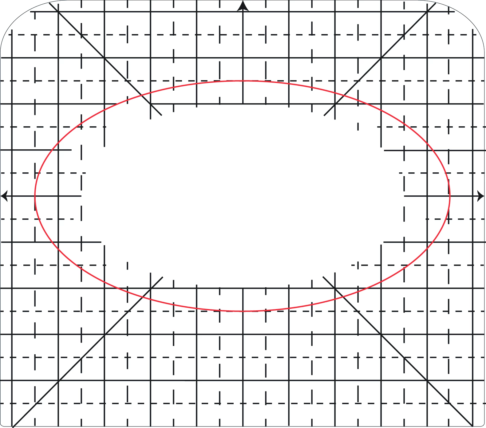

I am trying to delete stroke lines beneath a shape.  Imagine several random lines inside a square.  Now delete the lines that are beneath a shape (Circle) within the square so that the now empty space reflects that circle shape.  I can do this if there is a shape over a shape, but I am having trouble with a shape over vector lines. Thanks!

    If you are fine with line cutoffs that follow the shape and angle of the circle (rather than having Round or (perpendicular) Butt Caps), you can:
    1) Give the circle a black fill and no stroke,
    2) Select both the circle and the lines (you may have them Grouped), then in the Transparency (flyout) click Make (Opacity) Mask with both Clip and Invert Mask unticked.
    That should make the parts of the lines within the circle invisible.
    miqui515
    miqui515Author
    July 12, 2019
    That worked great until I went to print it on the laser machine.  The laser still sees those lines and prints them.  Bummer!  I think I need to actually delete those lines.

    Are you using PostScript (emulation) on the printer, or what happens if you do, if you can, or what happens if you Save a Copy/Print as PDF then print from that?
    In your post #4 there seems to be an elliptical void and a larger red ellipse; which is the Clipping Path?

    Would you be able to show us a screen shot of what it looks like?
    miqui515
    miqui515Author
    July 12, 2019
    Peter Villevoye
    July 13, 2019
    In order to let laser cutters and other strictly path-based devices work properly, it's crucial to convert all kinds of complexities like line widths, arrowheads, pattern fills, and masks to plain shapes (simple paths with a fill). You can do this by using the Object – Expand command (or Expand Appearance). Depending on the design at hand, you might need to use this command multiple times (e.g. with pattern fills or symbol sets). And Masks need to be released and rethought and re-applied with PathFinder operations. Using the Crop option on resulting shapes is very useful, or using Divide in combo with Add and Subtract. The Shape Builder tool (NOT the Shaper) can mimic many PathFinder operations and even get rid of loose paths.
    Just like you say: it should work like a cookie cutter, but cookie cutters only work on soft pieces of dough – not with patches or threads of wool, or steel cans with varied content...
    And a good designer also keeps in mind the specific requirements of the hardware, like minimum corner angles and line widths of cutters, or the rounding corner effect of the drill.
