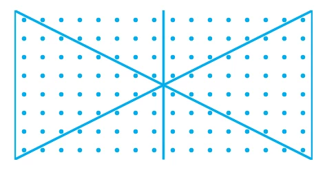

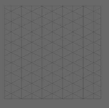

Does anyone know a good way to make a highly detailed isometric grid within Adobe Illustrator? I want the grid to look like picture 1 rather than picture 2. Ive searched the internet for a while now and all i can find is tutorials to create simpler isometric grids like picture 2.
Thanks!
Picture 1:
Picture 2 :

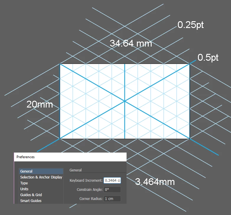

You can combine the steps in the video Bahaar mentioned with the pattern steps Mike wrote about already. This will create a pattern with both major and minor axes. Looks messy, but you only have to draw one 2cm vertical line.
Here's some numbers to use when you follow the video:

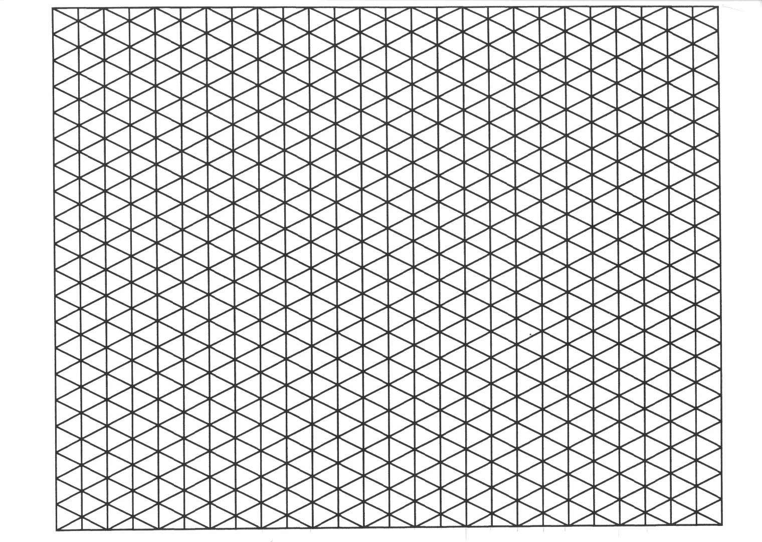

Here's the end result. My son likes 'triangle paper'.

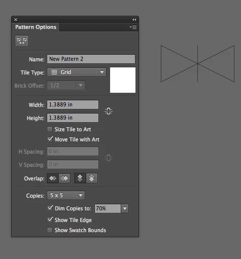

Mike_Gondek10189183
March 30, 2017
Draw  shape on right, and use default option in object pattern make.
Draw the triangular shape to an even numbered size, and add the dots stepping and repeating by a evenly divisible of that size

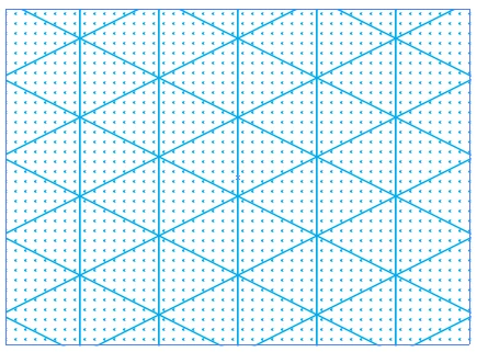

Mike_Gondek10189183
March 30, 2017
Sorry could not finish earlier had to help someone at work.
You will probably want to put a mask over the object before you create a tile, this will trim the stroke edges to an exact 2" x 1" (size I used)  tile.
