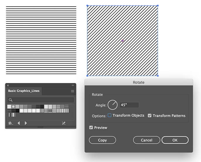

The easiest way, create a horizontal or vertical line pattern with the Pattern tool or use one of the pattern library from the Swatches panel and rotate only the pattern.
