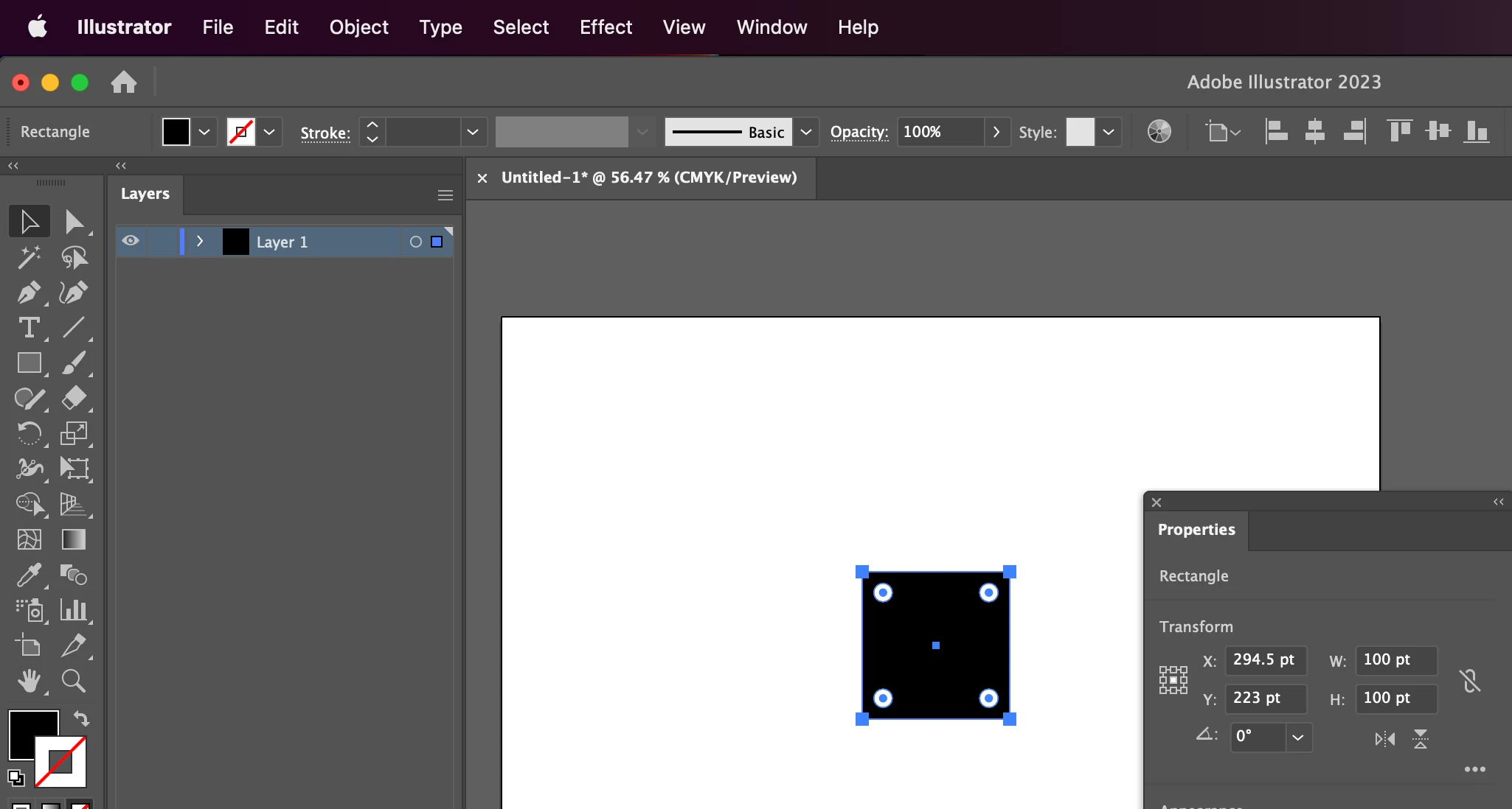

Since Illustrator 27.0 I have a problem with the size of objects:
E. g. I draw a rectangular with 100 x 100 px. When I click on this rectangular and look in the check box for the size there is shown 101 x 101 px. (The same in mm: I create a rectangular in 10 x 10 mm and the check box says 10,1 x 10,1 mm.)
Big question: Which size is the correct one? The size that I have drawed or the size shown in the check box?
In Illustrator 26 the size shown in the check box was the same like I have drawn it.

Is "Use Preview Bounds" (Vorschaubegrenzungen) turned on or off in Preferences > General?
If it's on, it will include the stroke width in the measurement

You can use the properties window to get accurate sizes.
Udo WittAuthor
February 1, 2023
More or less thar's what I do ...
Creating the object ... and that is the result ... (sorry, I use the programm in German)
But until Illustrator 26 the check box said in this case also a sitz of 100 x 100 px. It cannot be that I have to change each object now ... 😞
