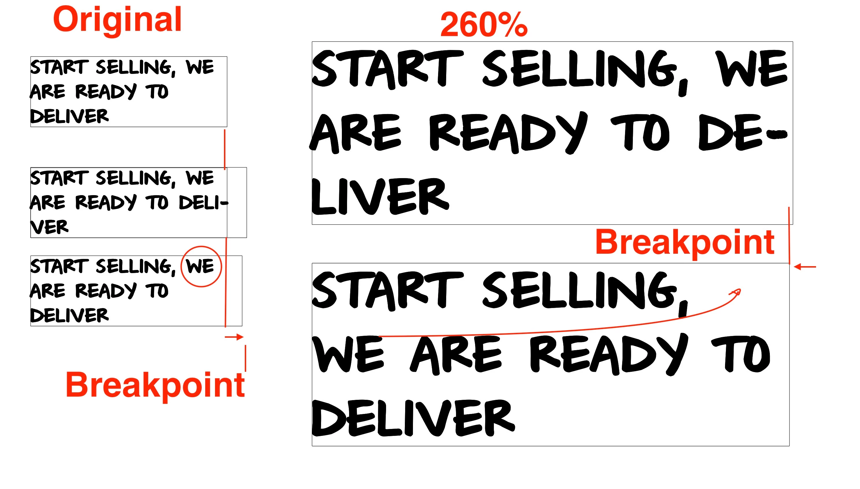

If you scale a text frame in the current Illustrator on Mac (at least), the text in the frame will scale differently compared to the original text frame!
I did not find any fix so far ...
It does not deal with any unit conversion.

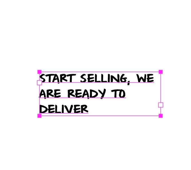

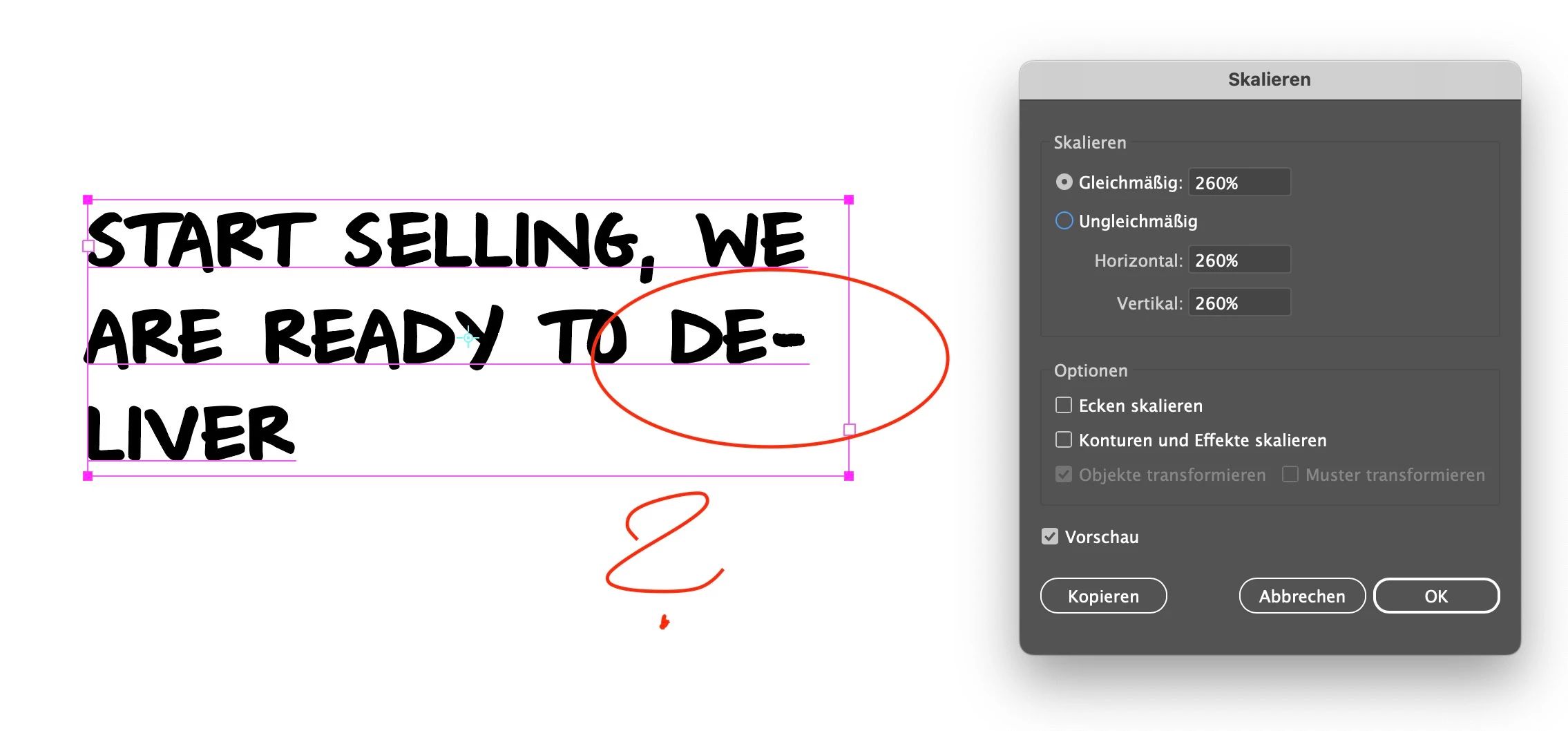

Original width of text is 33,537 mm and it get's 87,197,mm, like it should (260% exactly), and text will be scaled from 9,953 pt to exactly 25,878 pt, exactly what it should be.
But text will be wrapped in the big size frame and not break until the text frame gets smaller than 81,755 mm! So there is -5 mm(!) buffer.
But text will be wrapped in the small text frame completely different. It will break at 36,891 mm, wich is more the +3mm compared to the original width. (and it will be wrapped completely different in Deli-ver with we and the end of the first line versus De-liver in the big frame with we in the second line!)
So this issue deals with an unexpected and complete different hyphenation.

This is probably happening because of a very slight imperfection when internally converting units. Because this syllable should actually fit in the smaller version as well.
But text will be wrapped in the small text frame completely different. It will break at 36,891 mm, wich is more the +3mm compared to the original width. (and it will be wrapped completely different in Deli-ver with we at the end of the first line versus De-liver in the big frame with we in the second line!)

Internally there are always unit conversions. Internally the app does not operate in mm.
In the Hyphenation settings, can you check out the Hyphenation zone? And make that smaller or larger?
