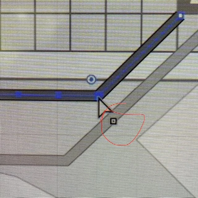

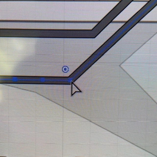

Illustrator 29.4 (64-bit), The direct selection tool cannot grab a selection by anchor point after recent updates.  While working with a group of entities (three layer line segments, with identical node count and positioning), I used to be able to select/isolate a group using the Selection Tool (V), once the group was selected/isolated I could switch tools to the Direct Selection Tool (A), then grab a portion of the group and reposition that portion by dragging, using one of the nodes in that selection as a handle.  This was especially handy when repositioning and aligning the node handle with the grid when consistent spacing is required.
I noticed that when this issue happens, it hasn't been consistent; there is no indication that the cursor senses the location of the node I wish to select.  The following images show different cursor responses that have been observed.  The first image shows the icon that indicates node presence, the second image does not.  These images were taken from the same project, but are of two different sub-groups within a parent group containing 14 identical groups of the same design.
