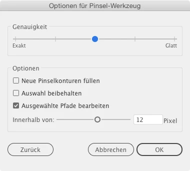

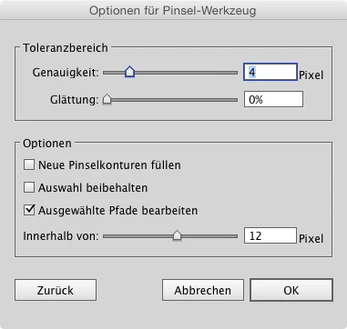

Monika Gause
October 11, 2020
The whole thread concentrates on doing just that. Everyone who posted in this thread is referring to that dialog box and the new things that were introduced to it in version CC.
Old:
New:
Maybe you have never seen the old one.

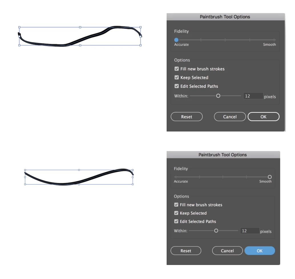

Doug A Roberts
March 28, 2018
i see a marked difference in fidelity from one end of the slider to the other:
there used to be sliders for both Fidelity and Smoothness but the interface was simplified (for better or worse) some versions ago.

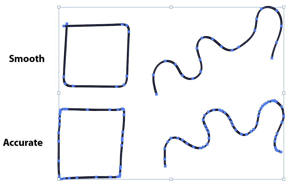

chanaart
March 28, 2018
The options for the brush panel in Illustrator will tell you if it is a smooth drawing. Try the options and see what it does. In the image enclose it is the same drawing one is accurate the top one...more anchor points. the bottom one is smooth less anchor point!
