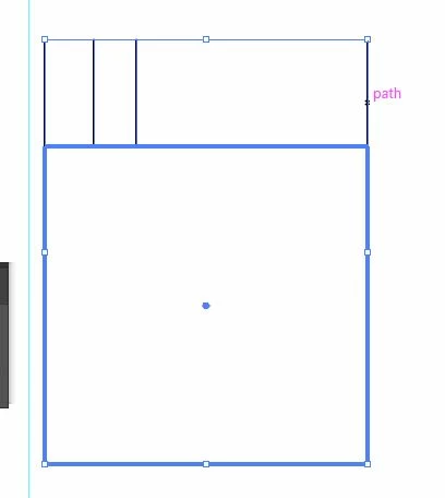

Hi..I have attached two snips here. I have to know the three equal parts of the square, so i decided to draw 4 lines starting from right corner to the left corner of the square (snip 3) and then made the square as key object and aligned the 4 lines to distribute horizontal centre..I expect that first line and last line will be on each corner and the between two lines will be distributed equally giving me a reference for 3 equal part of the square..but i dont get the expected result when i do that, instead all the lines are aligning together to the centre of the square (snip 4)...since it is a square i can easily calculate measure and divide it..but sometime i use this in other shapes and there also i get this problem...i dont know what i am doing wrong here...would be great if I get a solution..thank you..

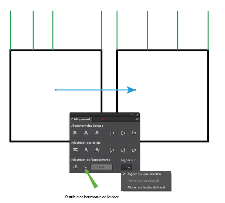

Bonjour,
Tracez 4 traits dont deux alignés sur les coins du carré.
Sélectionnez les 4 lignes.
Dans Alignement choisir Distribution horizontale de l’espace
avec l'option aligner sur une sélection cochée.

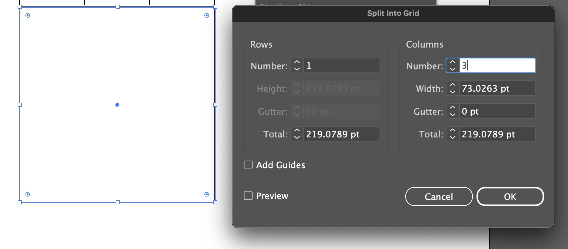

Select sqaure
Object >> Path >> Split into grid: 3 column

November 30, 2024
Left-align the square and the left line.
Right-align the square and the right line.
Distribute horizontal space only on the 4 lines.
It is important to remove the square from the selection at this time.
