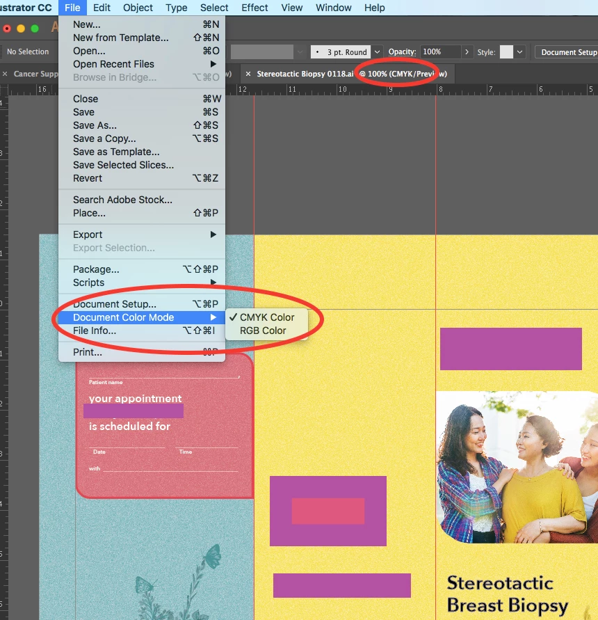

If anyone can help with this one I'll be so grateful.
So I start a new CMYK document and trust that any colors I use when creating objects in that document will be CMYK, right? A simple example: colored background for a trifold brochure plus some text. Document color mode is showing as CMYK in the document tab and when I go to File- Document Color Mode- CMYK. When I'm done and export to high quality print or press quality PDF, then send it to the printer, I get a proof back from the printer before it's ready to go and the colors look way over or under saturated. I ask what's going on with the color and they respond that I sent my document in RGB. Eh? I open the file back up in Illustrator and check; document color mode is CMYK. But then I select any colored objects throughout the document and go to Edit- Edit Colors and see that Convert to RGB is grayed out while everything else is open to select. Does that mean the object is in RGB? I assume so. I click "Convert to CMYK" and again assume it's good to go as CMYK. I do this with the other colored objects in the doc, then I check that my work was not in vain, that I did indeed convert everything to CMYK. But it's still showing grayed out Convert to RGB and everything else is open to select just like before. Does that mean that all my colored objects are in RGB? How in the heck do I make objects CMYK if not the ways I just described? Where am I going wrong?!

. . . document color mode is CMYK. But then I select any colored objects throughout the document and go to Edit- Edit Colors and see that Convert to RGB is grayed out while everything else is open to select. Does that mean the object is in RGB? I assume so.
No. Convert to RGB is unavailable because the Document Mode is CMYK (so RGB is not supported).

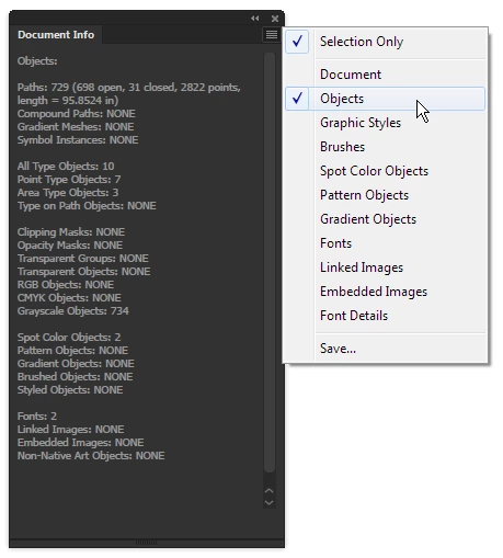

There are several ways to know exactly what's in your file. One easy way is to use the Document Info panel.
Make an appropriate choice from the panel menu, and then make a selection to see how it registers...

When you set up that document in CMYK and it shows CMYK in the title bar then it's a CMYK document. Conversion only takes place via File > Document color mode > ...
But when saving a PDF several things might happen when you set up wrong color options:
- conversion to RGB
- assigning an inappropriate color profile
- even conversion into a different CMYK profile
Also when the printer open the PDF not in Acrobat, but some other application bad things might happen.
You will need to check all your PDF options.
You will need to always check your PDF in Acrobat Pro before sending to the printer
You will need to learn about color management and set it up correctly
