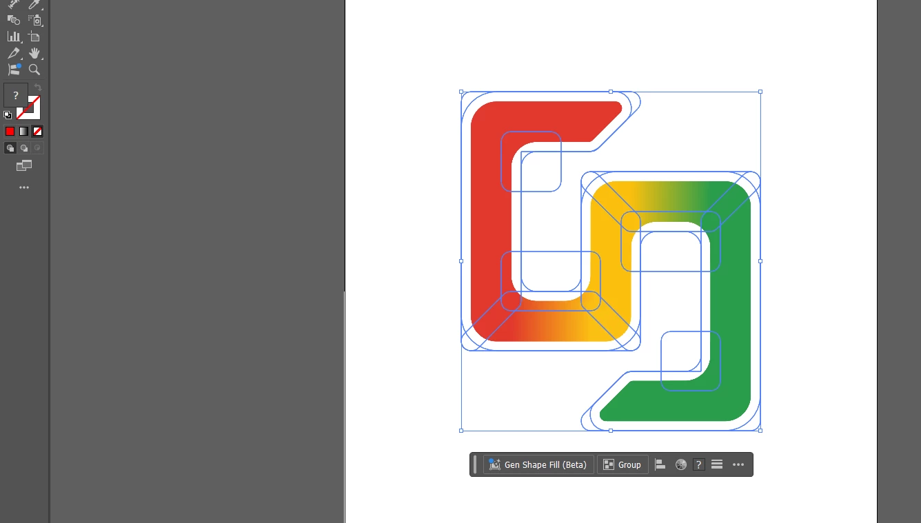

I would like to increase the thickness of the logo (image 1) like in the second image which I got chat GPT to render, although maybe not quite as thick - what is the easiest way to achieve this?
I created the attached shape (image 1) using a grid split into triangles, The logo is made up of multiple different shapes - red section, green section, yellow section, red-yellow gradient section, yellow-green gradient section, I also had to add gradient rectangles in the negative space within the logo after making the corners curved so that they inner curves would capture the gradient in a clipping mask.
Any help would be much appreciated!

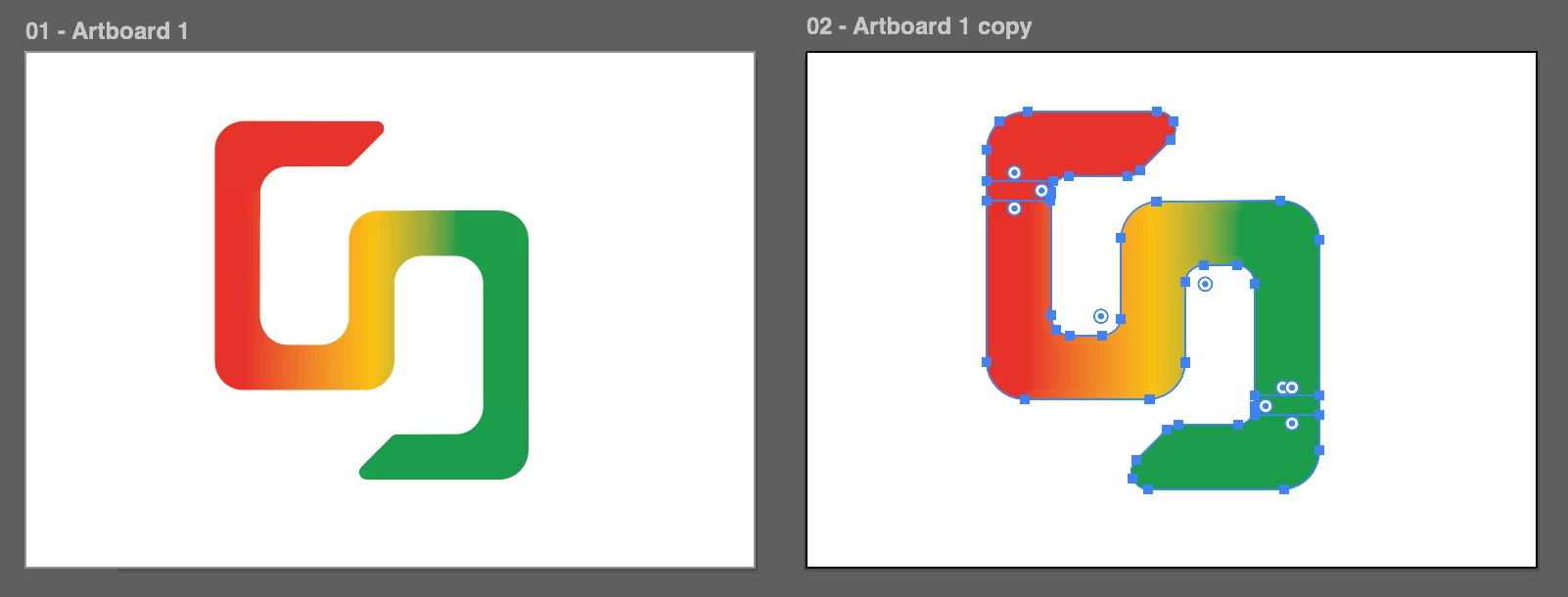

Jacob Bugge
June 11, 2026
NB,
Strangely, the shapes in your attachments are fundamentally different to those shown directly in your post:
In your post, the top left and bottom right corners are (almost) sharp, and the end corners are sharp, and the top and bottom horizontal parts are thinner than the parts in between.
In contrast in the two attachment shapes, all corners but two are rounded, and the all the parts have the same thickness.
So judging from your post shapes, you seem to wish to keep the sharp corners and thinness of the top and bottom parts, and increase the thickness of the parts in between, with the corresponding change of the overall shape which is obviously wider.
Obviously, this requires a customized solution.
The shapes in your attachments are fundamentally different, suitable for a simpler solution.
At first glance my impression of your post shapes was that you wished something somewhat like the second image, only more consistent including identical thinness of the top and bottom parts.

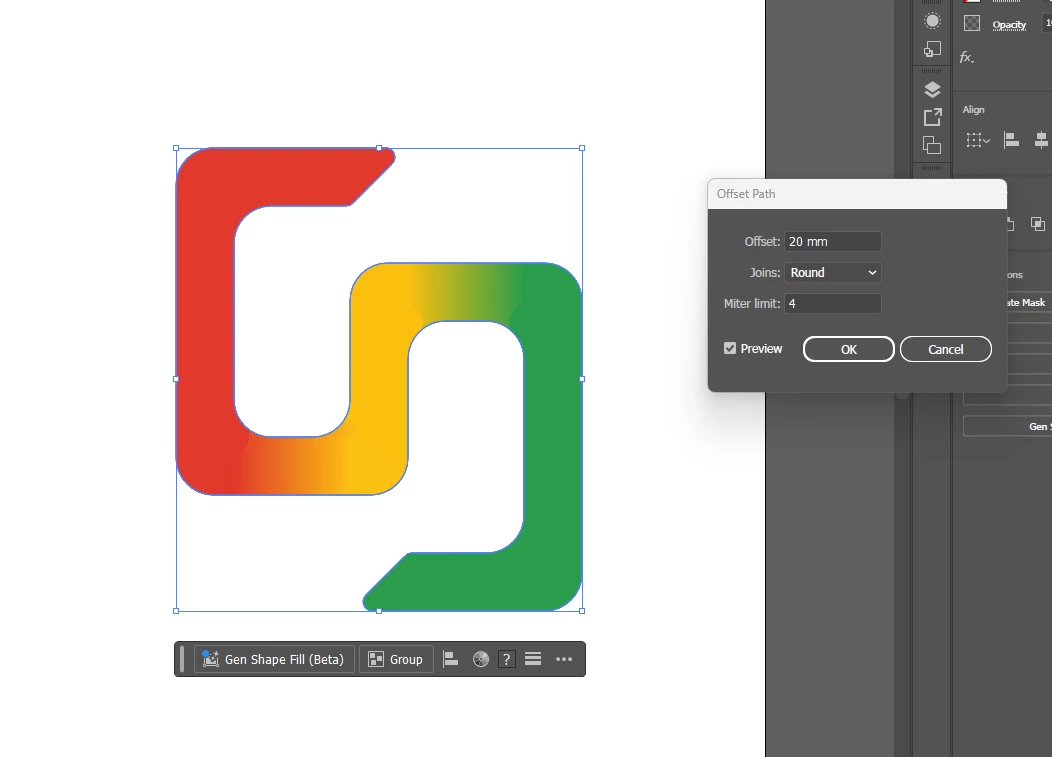

NB_Scott
NB_ScottAuthor
June 12, 2026
Hi Jacob - not sure im following.
the below attachment shows the build up of my shape after attempting to use offset path - the second image I posted initially was just a chat gpt render to show roughly what im trying to achieve.

NB_Scott
NB_ScottAuthor
June 12, 2026
Thanks Ton,
I tried this but still getting stuck - when I use offset path it throws off the gradient, and also just creates an outline rather than expanding the shape - am I doing something wrong? See below images for clarity.

NB_Scott
NB_ScottAuthor
June 12, 2026
Thanks Monika,
