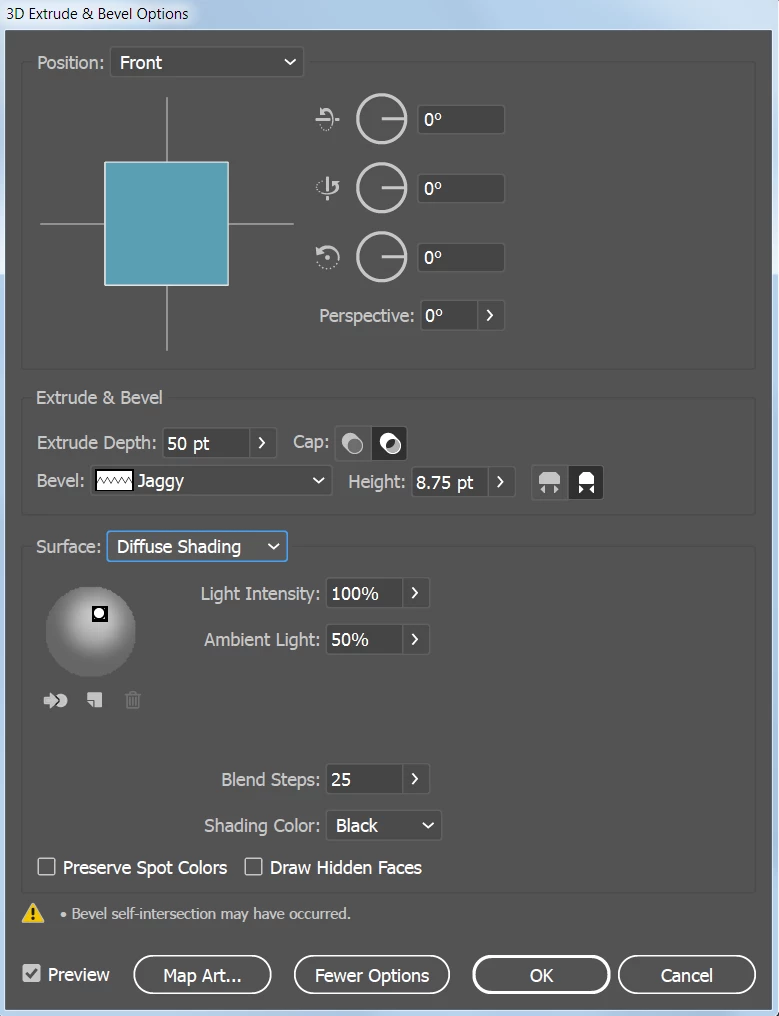

    However, that does not give you round caps. Once everything is final, you'll need to draw the paths as Jacob Bugge described. Make a copy of the "live" graph before doing that so that you can edit the data if it happens to change later.
    By the way, I was able to get a raised look using these settings on the clipping mask, but not the rounded caps.
