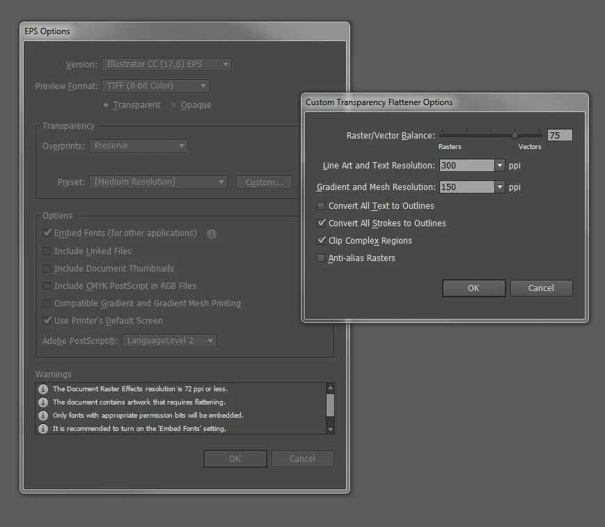

    Aug 21, 2023 10:06 PM UTC
    So I know this is an old post but I do have another fix for the double cut line problem of the CutContour path in eps files saved from illustrator.  As Ton Fredericks mentioned, this problem is due to transparency flattening with the CutContour visible during the flattening process. By default, strokes are converted to outlines which is why Ton recommends hiding it before flattening. Then unhiding it before saving it so it doesn't get converted.
    But if you have a file with transparencies as well as a cut line and just want to save the file, you can with an adjustment to the transparency setting in the save as process ... which is what I do.
    There's a transparency flattening setting that converts strokes to outlines when the file is flattened during the save process.  When you select save as and choose eps ... the next screen is where you can choose the transparency setting that needs to be altered.  The preset is usually set to medium or high resolution.  Click the "Custom Button" and deselect (uncheck) the box that says "Convert All Strokes to Outlines".  Click Okay and okay again to save your file.  Now any printer RIP Program that uses the "CutContour" path for cutting will remain a single line.  When the path was getting converted, the stroke or path becomes a compounded object with a fill.  Also, you'll want to make sure you don't have your cut path selected if you are manually converting your objects to outlines ("expanding") before saving files for print.  Programs like Versaworks and Onyx use CutContour for cutting.
