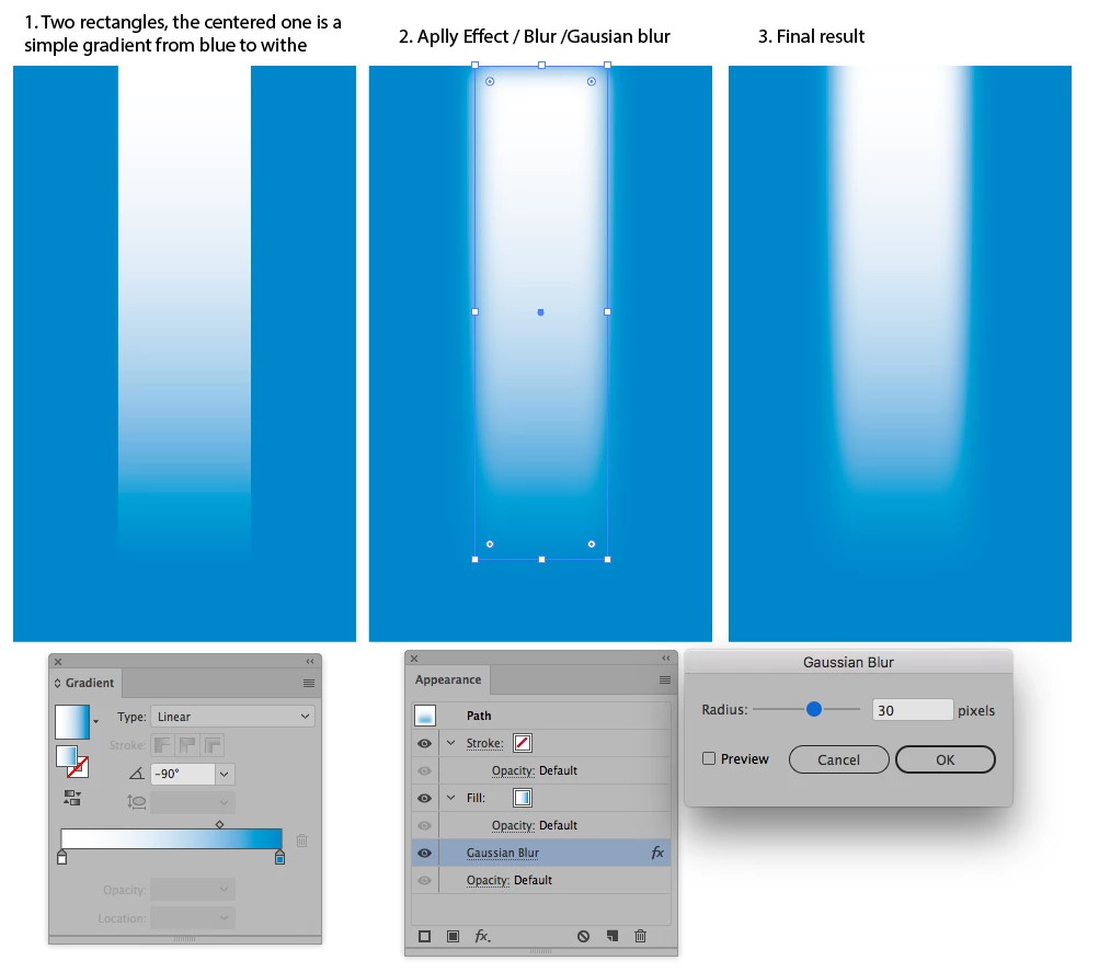

Mario Arizmendi
May 8, 2018
Here is another way to do it
JETalmage
May 9, 2018
Mario, you're using a raster-based effect, which carolined38383620 expressly is trying to avoid.

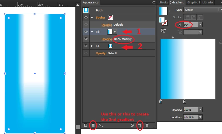

JETalmage
May 8, 2018
In the Appearance palette, simply apply two grad fills to the object. Set the opacity of one of the stops of the topmost fill to 0.
Complex gradients always get rasterized one way or another, so insisting on vector-ishness is pretty much a moot point.
Not so. In a very generic sense, everything destined for print eventually becomes rasterized before ink hits paper. But vector-based grads have been a normal Postscript construct since the beginning, transparency support was added later, and Mesh grads after that. Even Mesh grads remain vector objects up to the RIP.
All you have to do is try it. Create the two-fill object as explained above. Save a Copy as a PDF (without Illustrator editing retained). Open the resulting PDF in Illustrator and tear it apart. There will be no raster objects.
JET
PCreater
May 11, 2018
I can't understand how you did this with gradients only. Will you please explain more.
May 11, 2018
Go to the appearance panel.
Select Fill and setup the first gradient colors.
Then create a new one or duplicate the 1st gradient.
Change the gradient settings including the rotation and transparency blending mode (Multiply).

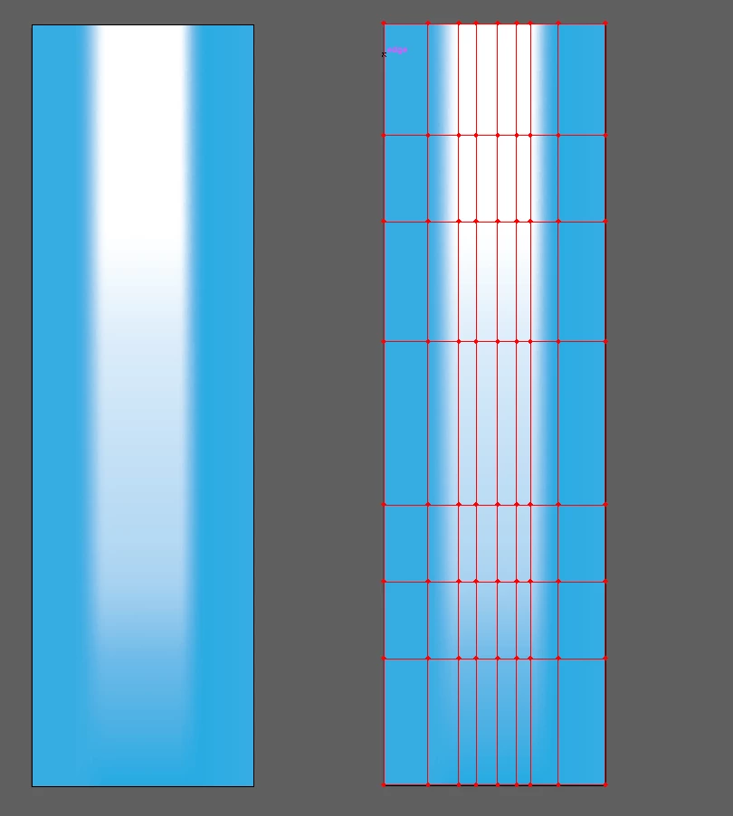

ShakeN93
May 8, 2018
Maked with Mesh Tool :
carolined38383620
May 8, 2018
Thank you so much!
