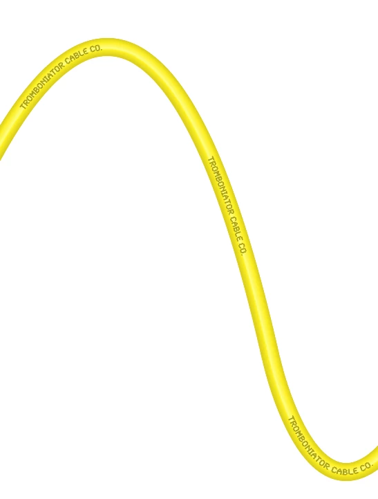

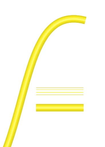

    Here's a somewhat more complicated example of what Jacob is talking about, using a blend of line segments with 1 pt. stroke of varying shades of yellow, and spaced to give a sort of 3D appearance. Select the line segments, then Object>Blend>Make and Object>Blend>Blend Options>Smooth Color. In the Brushes panel make it an art brush or pattern brush, depending on how you want to use it.
    Peter
    October 16, 2010
    Thanks for all the help.
    Trombinator - you're example is the best for what i need to do, but i cant get a smooth colour gradient. You can see the steps in it...
    http://www.error1.com/images/wire.jpg
    And the thinner the wire is, the more the colour steps are apparent, because they dont get smaller when the wire is resized.  When selecting Smooth Colour in the blend options it does not affect it. But i've noticed when bending any of the lines it suddenty makes the gradient perfectly smooth... so this might not be a problem once i've shaped the wire. But how did you bend the wire in your images?
