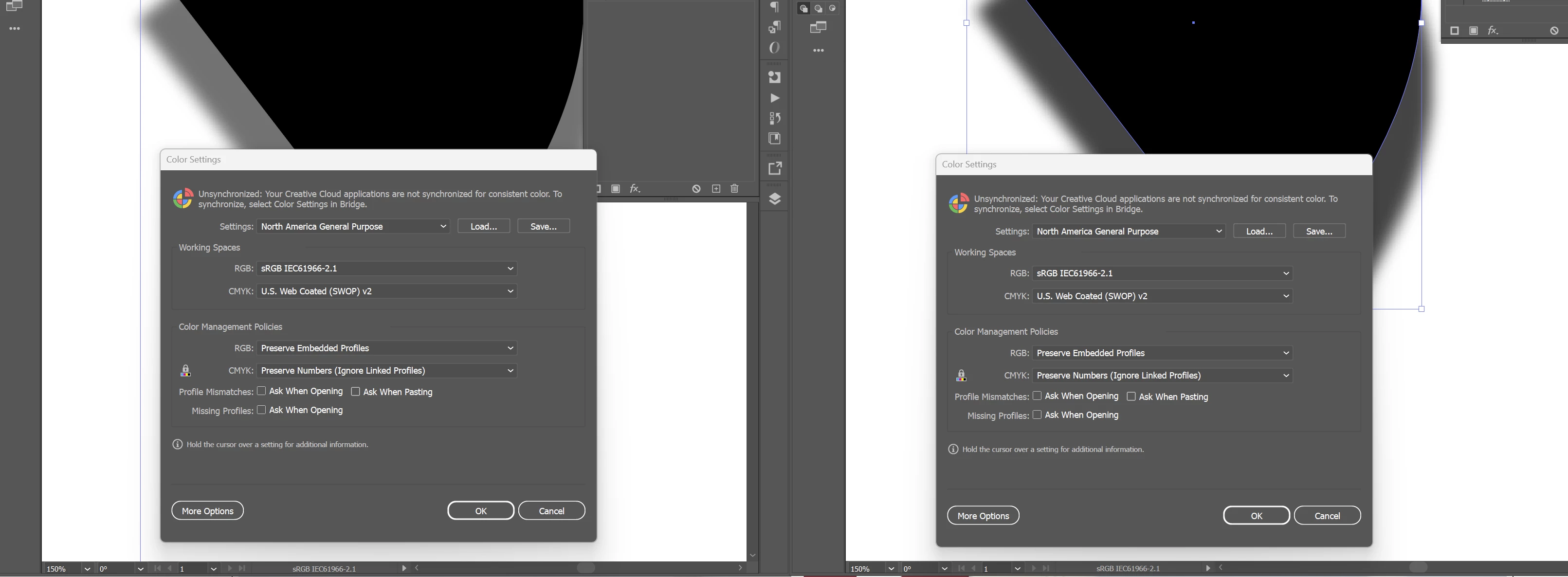

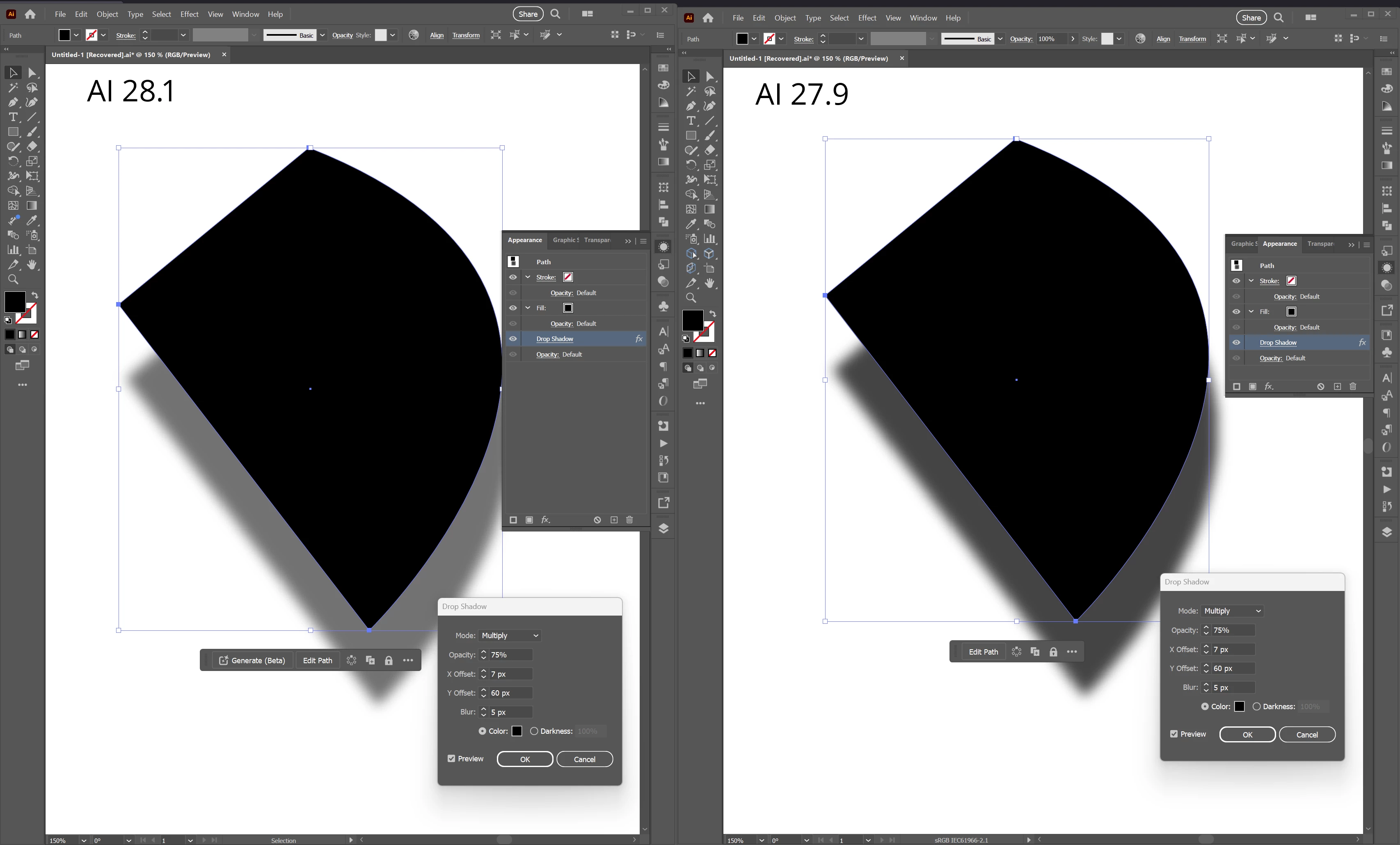

I've been testing this today and found a definite difference. This is side-by-side on the same monitor:
Colour settings/profiles identical (as it's the same file):
I've asked the question in prerelease, will see if they respond.
December 13, 2023
I rolled back a version, and it is displaying correctly, so I think it does have something to do with 28.1.

December 14, 2023
As Ton already guessed: your color management might be set up differently which could explain this.
December 14, 2023
I'm not sure how it would be different in 28.1 if it's working fine in every other version though. My settings have not changed.
Ton Frederiks
December 13, 2023
How is your color management setup?
December 13, 2023
I'm not sure if I'm understanding your question correctly. Could you clarify?
EDIT: I understand now, this is referring to "Color Settings".
