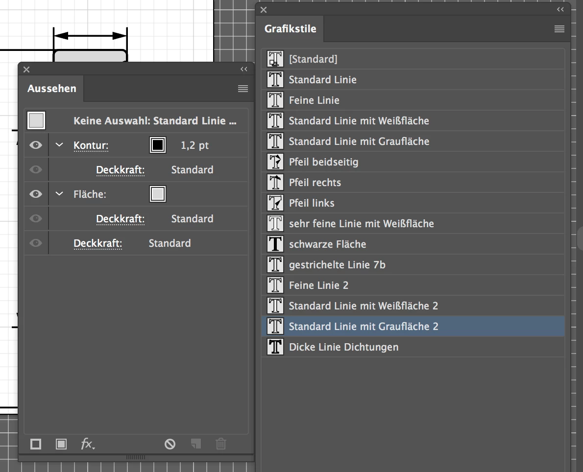

When I copy objects that are linked to graphic style from one document and paste them into a document with the identical graphic styles (Same appearance, same name) new graphic styles are created with the same name plus appended numbers. Is there a way that the graphic styles are not duplicated, so that I don't have to delete the duplicated styles manually?
I would appreciate very much your help.
Daniel

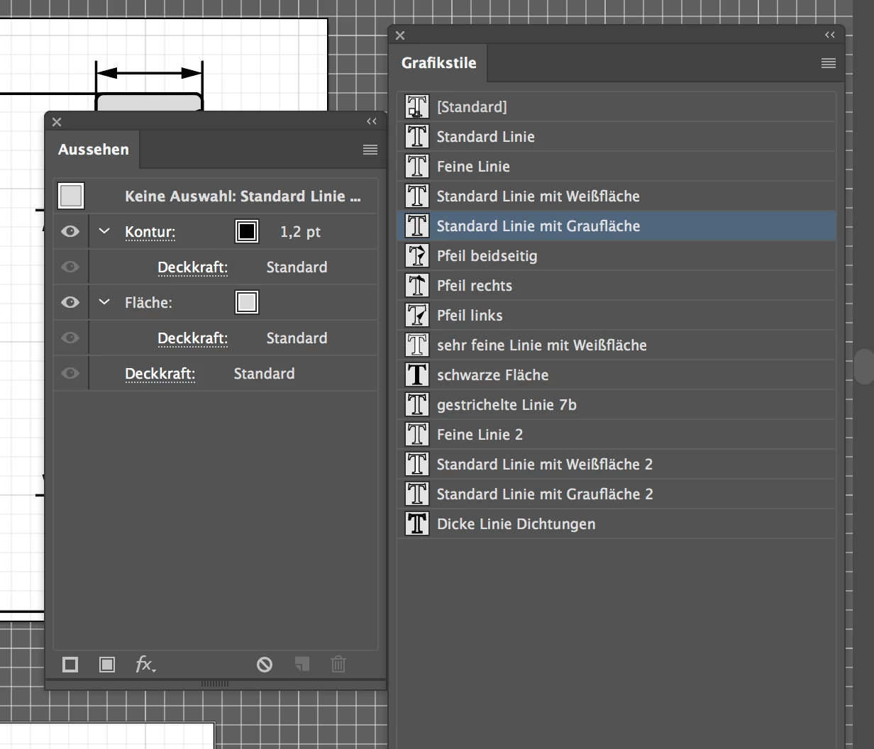

If I open "example1_cs6.ai" selected and deleted all unused styles. I draw a fresh new line and assign the graphic style  Feine Linie to this, every time I copy paste this line within the same document a new Feine Linie2... Feine Linie3...  appears. The other styles seemed to be good.
To fix I created a new stroke and matched the settings black 1 pt stroke. I then option dragged the stroke on over "Feine Line" swatch in graphic styles to replace all settings. Now when I copy a stroke with the updated settings to "Feine Linie" that no longer duplicates.
So you may need to recreate the problematic ones you have, and option drag over graphic style to redefine.

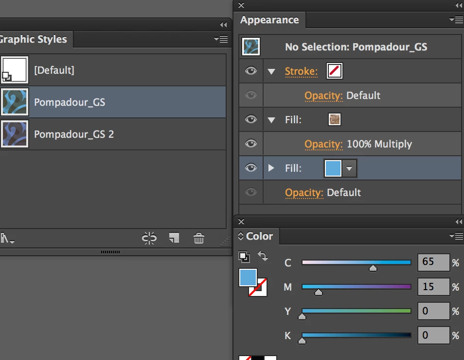

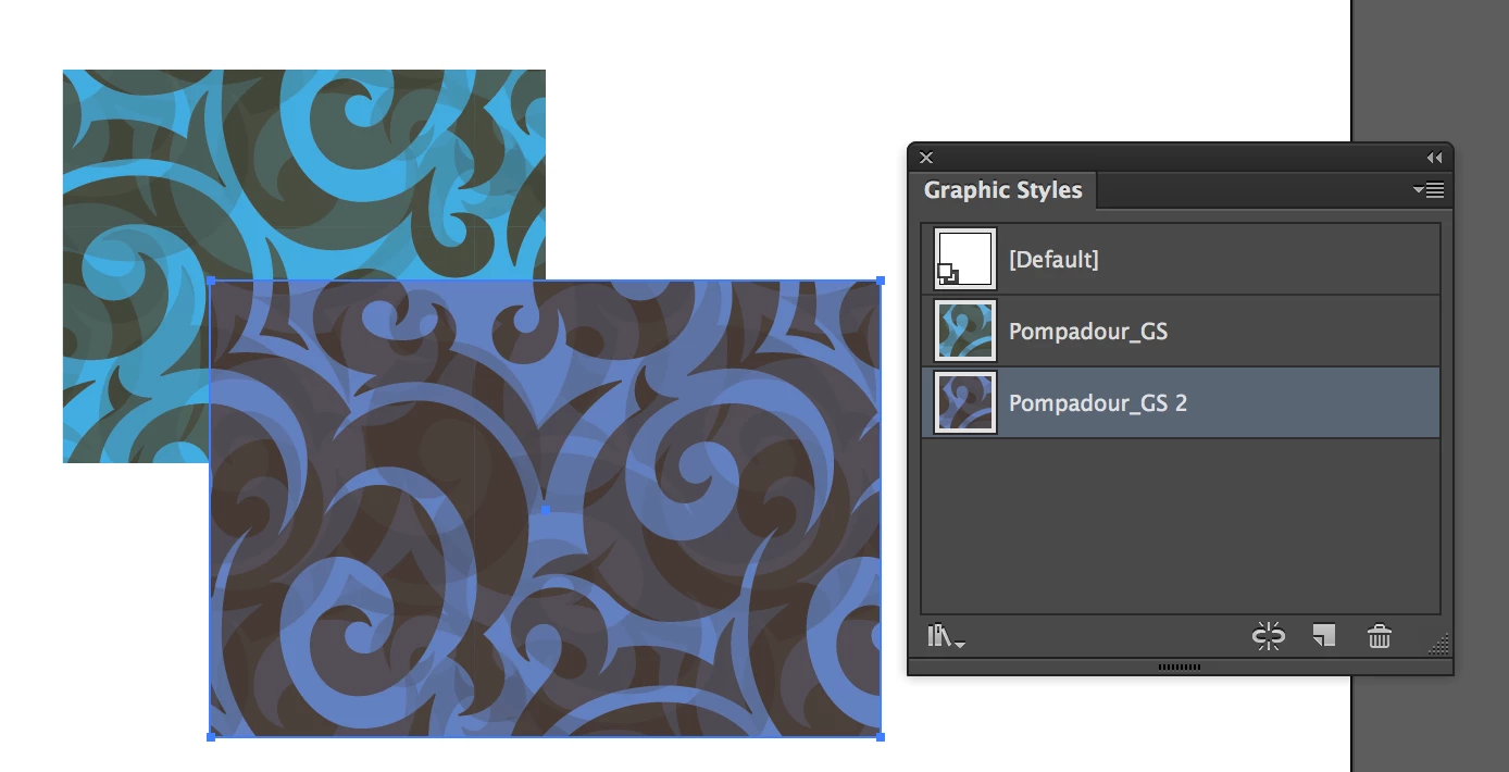

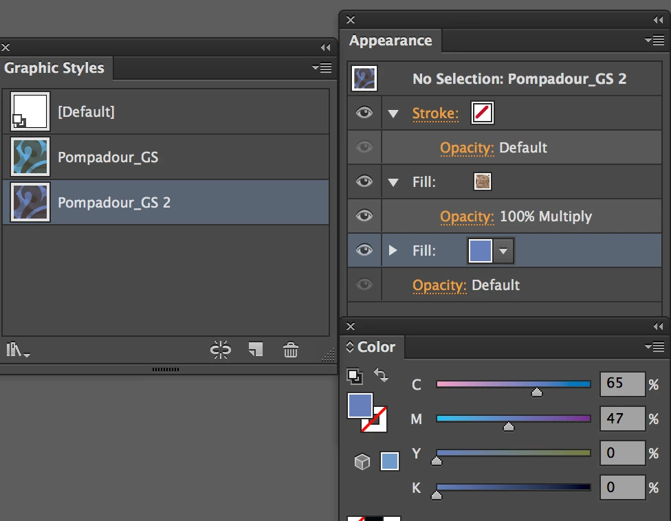

markdc33
Jul 11, 2024 6:41 AM UTC
The cause for me: "Global" color swatches which were born and raised in a CMYK document, hopped on a CC Library, landed in an RGB document, and at first glance were upright citizens, but their "true colors" showed when they hooked up with the clipboard, causing a Dark Matter event.

Mike_Gondek10189183
Apr 17, 2018 4:52 PM UTC
If that is happening, there must be something different about the graphic style. If you move the fill color color even 1% will do that.
You could compare them in appearance to see if something is different.
BENKUEPAuthor
Apr 18, 2018 10:41 AM UTC
Thanks for answering. I have checked it. The appaerance is identical.
