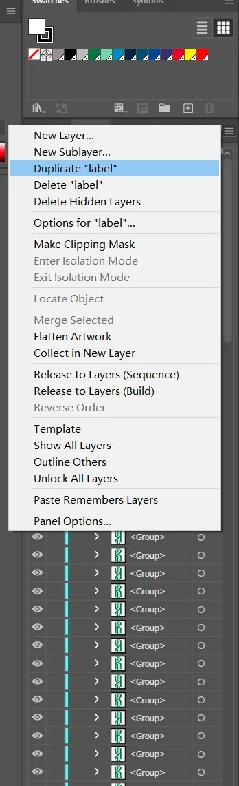

How to access the “Duplicate Layer” command in the layer panel with a script? I tried to find the relevant properties or methods in the script reference file, but I couldn't find, I also try to use the "ExecuteMenuCommand" methods, but I don't know what the corresponding command is. If there is no direct property or method, is there a script that can achieve the same function?

If I am understand your question correctly, you want to duplicate multiple layers all together. If thsi is the case, then you need to select the layer each time before running the duplicateLayer method. Below is the snippet that will duplicate all layers in the active document.

Charu Rajput
August 12, 2022
You can use the action to duplicate the layers.

duplicateLayer();
Make sure, layer is selected in the Layers panel to dupliacte it.

Hi @Charu Rajput
This script work fine, thank you!
I want to make a loop to copy these layers in large numbers. It mean to execute this function in a loop. How do I realize it? Sorry, I know little about JS....
I tried below, but it can't work.
for (var i=1;i<4;i++)
    duplicateLayer();
