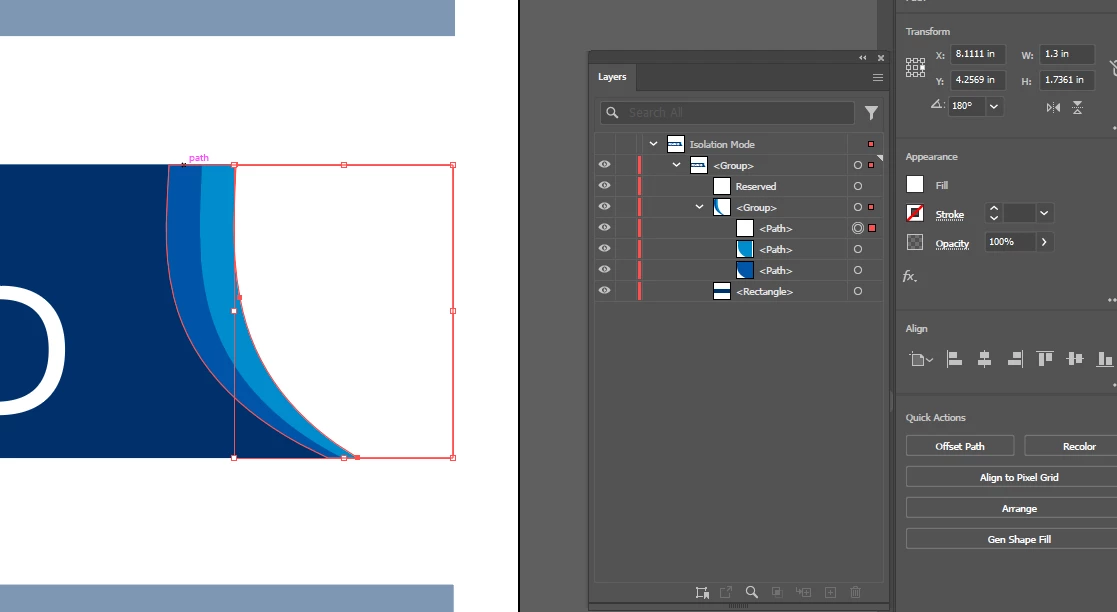

Edges of bottom layer's fills showing even with perfectly aligned shapes
Is there a way to avoid having the color from bottom layers show through around the edges of a top layer?
Ex: If I have two identical & precisely overlapping shapes with different fills on top of each other, the color of the bottom filled shape is visible around the edges of the top shape. This unintentional "outline" is visible when I export and print.
I was able to get around the issue in the attached screenshots by using pathfinder to create new shapes, but wondered if I was missing something that might save me extra steps.

A very close look at the first screenshot reveals something strange at the corners of the faint/narrow line at the right which seems to have the cyan colour: it looks like separate open paths with Butt Ends, in other words something different to the dark rectangle and the three paths in the inner Group.
What is the object named Reserved, and what happens if you hide/delete it?

This statement "If I have two identical & precisely overlapping shapes with different fills on top of each other," may be true, albeit only partially since only the right sides can be identical and precisley overlapping, but it would be nice to see both the white and the cyan (and preferably also the deep(er) blue selected and with Transform values shown with one of the right Reference Points ticked.
But whichever the issue, I believe you can mend it in the following way, working on a copy of the Group with the three paths, which you can hide and keep as back up, Smart Guides being your friends:
1) Lock the bottommost dark blue path,
2) Click an empty spot on the artboard, then with the Direct Seletion Tool ClickDrag over the two rightmost corners of the paths and press Delete; this ought to delete the straight segments of the white and cyan paths, leaving only the two curves to the left as open paths;
3) With the two open curves from 2) still selected hold Ctrl/Cmd and press X then F to copy them to the front, in other words above the dark blue path;
4) Deselect, then still with the Direct Selection Tool click each of the topmost end Anchor Points of the paths and ShiftClickDrag it a bit up and then down again to snap to the path beneath (Smart Guides say intersect), then do the opposite with the bottommost Anchor Point; this will ensure the two paths beyond the blue path;
5) Unlock the dark blue path from 1), then apply Pathfinder>Divide to have three closed paths in a Group, and then recolour.

A follow up: The artwork structure seems to imply that you started out with a very dark blue rectangle and then worked on ever narrowing copies made by curved cutoffs.
An option to start over might be to apply the three cutoff curves to the original rectangle, making sure that they snap to it with the help of Smart Guides, and then simply apply Pathfinder>Divide to have four closed paths in a Group, and then recolour.
