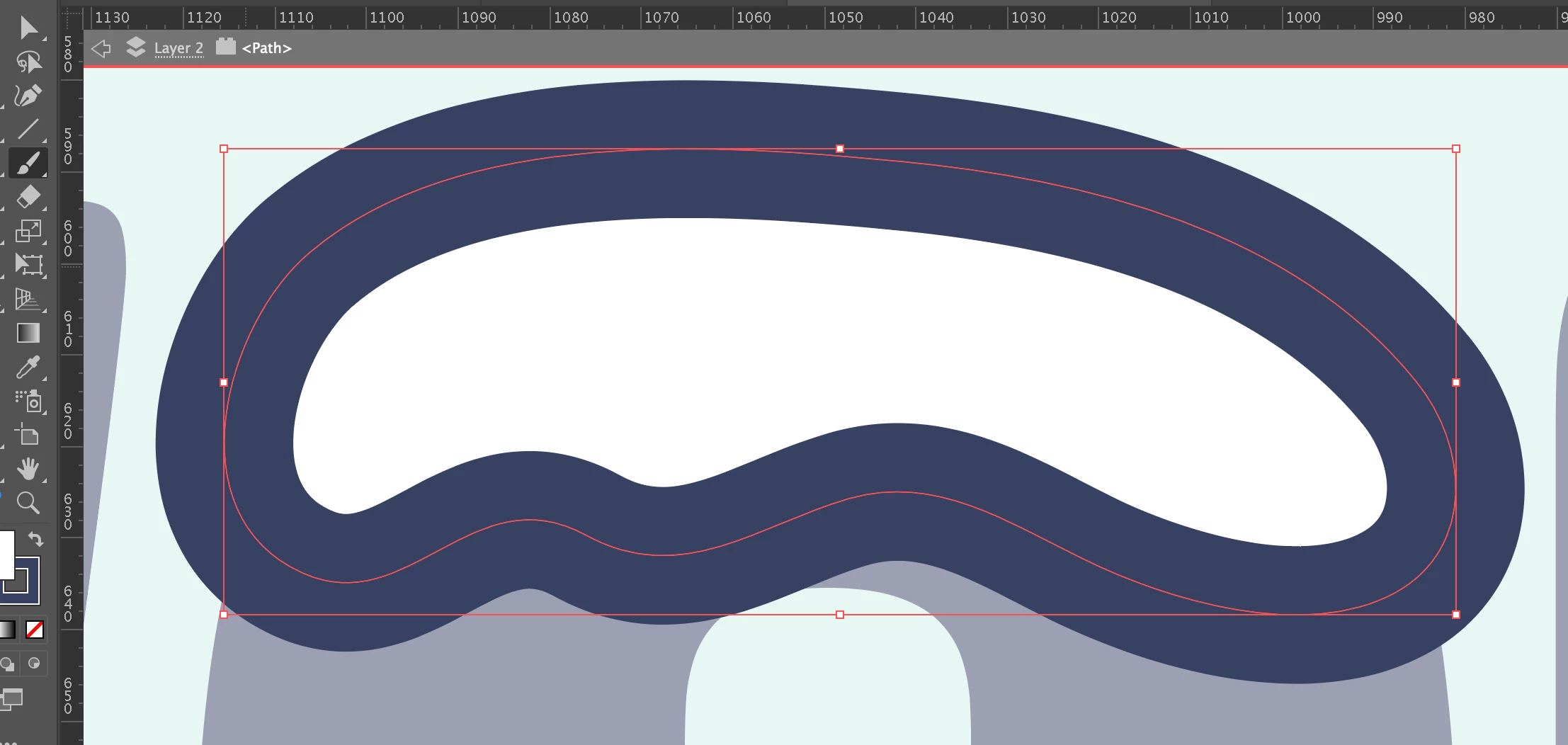

You currently do not have a brush (from the brushes panel) applied to that path. Can you try that? First apply a brush and then use the brush tool?
If you do not want to change the stroke of the path first, then you could check out the pencil tool instead of the brush tool.

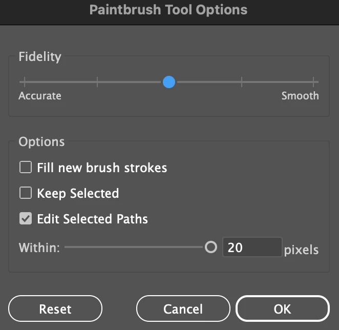

When you double click the brush tool in the tool panel you should see the relevant options.
Jan 24, 2025 9:03 PM UTC
Hi Monika, I looked at the options - and this is what I have.
It still doesn't directly edit the path.

And the path is seected?
When drawing with the brush tool: do you click and drag on the path?
