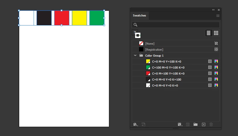

Monika Gause
January 9, 2023
Indeed the swatches need to be Global for this.
So the Swatch needs to be set up as global before you apply it.
What you can do afterwards is sue the swatches panel, delete all the swatches in it and then use the panel menu to generate swatches from the artwork. They will be global. But Illustrator won't generate gradient swatches from the artwork.

Monika Gause
January 9, 2023
You can select all those swatches in the Swatches panel and then in the menu open their info. In that dialog box "Global" is the only thing you can turn on. But that doesn't change the color on the objects

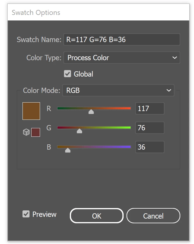

Doug A Roberts
January 9, 2023
quote
if I have embedded swatches ( meaning that the colour of the artwork is directly related to the colour of the switches itself)  Then if I modify the swatches it will automatically update in the artwork.
but so far I'm not able to reproduce this behaviour maybe I'm missing something very basic?
By @Max Mugen
This only works if Global swatches are used; see the checkbox in swatch options:
Gradients will work the same too if global swatches are used in gradient stops.
