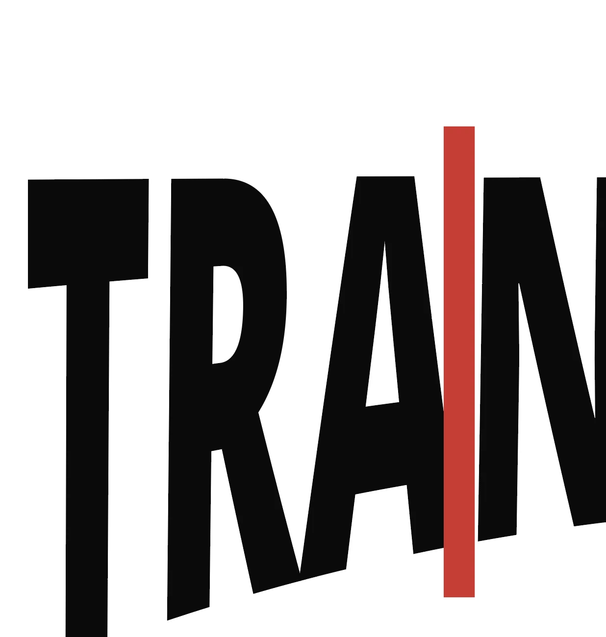

I'm trying to use envelope distorts to curve some text. In this example, I want the bottom edge of my text to be curved, and the top edge to be flat and the sides (left and right edges) of the each letter to be straight, not slanted.
I can get that - sorta - but the letters are slanted. The top edge is straight, and the bottom edge is curved, but the sides of the letters are not straight up and down.
I have tried adjusting the size of the text, creating outlines, etc. What am I doing wrong?

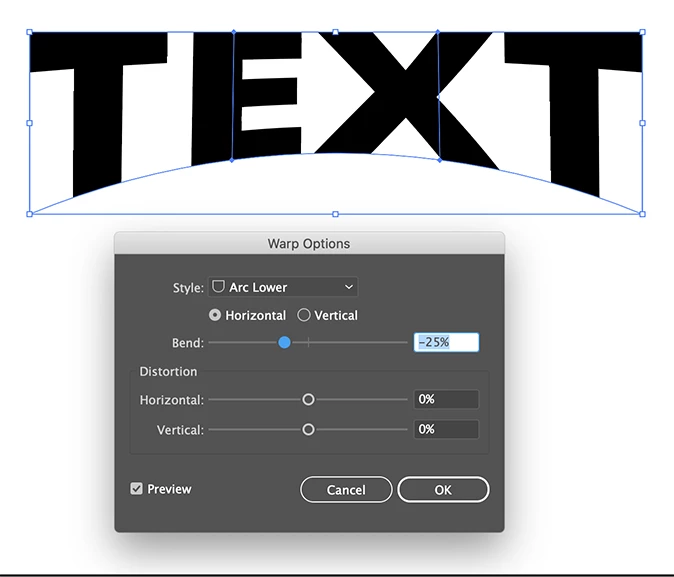

You can try warp, it will probably need some manual adjusting after expanding.

It is (one of) the old way(s) of creating vintage/old fashioned text, you can read on here:
https://community.adobe.com/t5/illustrator-discussions/how-can-i-keep-top-third-of-text-untouched-while-curving-bottom-half/td-p/12186490

The trouble with all warping is always the horizontal lines. If those shouldn't be distorted, then manual is your only way.
