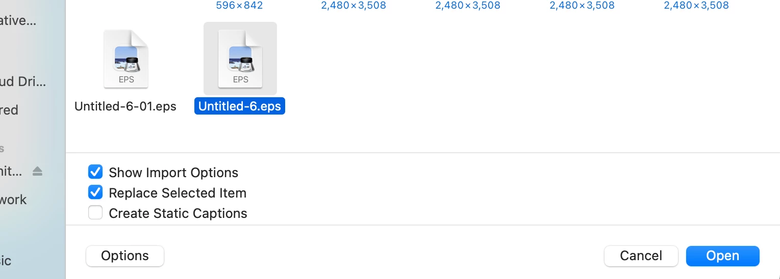

i did a illustration using illustrator. saved it as eps with transparent background. (ive checked transparent grid and it was all correct.) then when i place my eps file in indesign, a white background shows up. quite annoying as i need it done urgently for my coursework. ive tried my other eps file that ive done a few months ago and it works but the recent eps file just wont work. i tried opening a new document then tried saving it again but nothing is working.

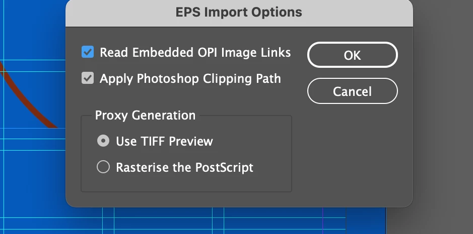

While it is correct to save AI/PDF, your screenshot looks like there is an additional issue.
When placing the file in InDesign you need to "Show Import options" and then also set the background to transparent on Import. You only need to do that once. InDesign will keep that option.
