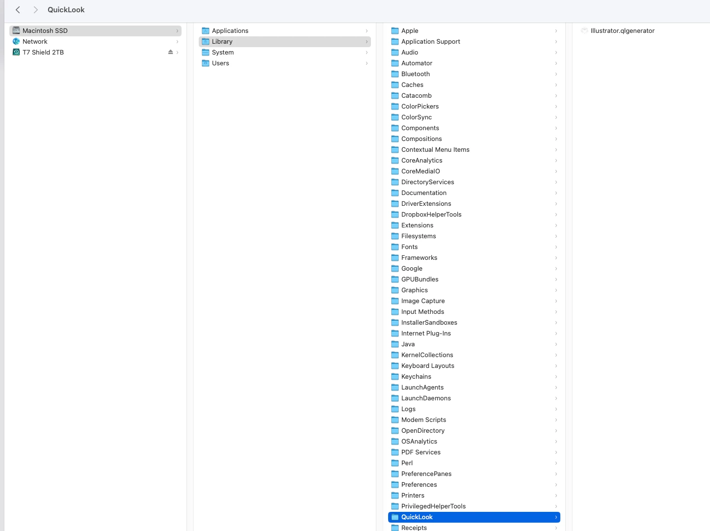

  • Copy the "Illustrator.qlgenerator" from "/System/Library/QuickLook" to your desktop or any other folder you have read/write access to.
  • Open "Illustrator.qlgenerator" by right clicking it and select "Show package contents".
  • Open "Info.plist" in the "Contents" folder with a text editor.
  • Find the line "<string>com.adobe.illustrator.ai-image</string>"
  • Insert "<string>com.adobe.encapsulated-postscript</string>" below it with the same indentation and save the "Info.plist" file and Save.
  • Copy "Illustrator.qlgenerator" to "Mac HD/Library/QuickLook"

Just came back to this post after getting a new Mac Studio and relising that I needed to do this again. Just to say if you follow the instructions it works perfectly. The bit that's easy to get wrong is where you copy the edited file to. It's not the libary you got it from in "Macintosh HD/System/library" but the top level library in "Macintosh HD/library"
