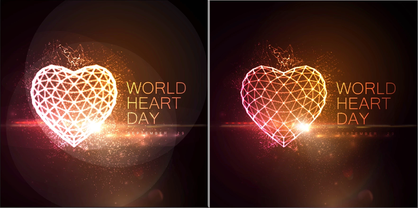

Hey guys! New here, and very new to Illustrator. Coming from Premiere Pro mostly as well as some Photoshop experience. So I'm trying to edit an EPS but when I open it in Illustrator it looks pretty terrible. Very different than the stock preview as well as the PNG. What am I doing wrong??
In the image you'll see the EPS open in Illustrator on the left and the PNG on the right. I want it to look like the PNG, I just need to be able to edit the layers...
thanks in advance!!

FIGURED IT OUT.
This was bugging me so I started poking at the construction of the actual gradients used in the file. Turns out they all used a Black defined as 100% Grayscale instead of an RGB Black 0R 0G 0B like the rest of the colors in the document.
So, here's the easy fix, open the file, Select All, and under Edit > Edit Colors > Convert to RGB.
Still, you might want to enlarge the file to a reasonable artboard size!

It's an EPS purchased & downloaded from Shutterstock. If you try to open it or place it in Photoshop it is extremely tiny and if you try to force it to open larger it looks terrible. I had also downlaoded the PNG from Shutter and it looks totally fine. Super strange! I attached the EPS file, and also the PNG for reference as to what it should like. I'd love to just use the PNG but I need to edit individual elements, like remove the text cleanly. Thanks for your help!

Holy doodle, there's definitely something weird with that file.
It's doing all the same things here that you've experienced. Even when placed in ID, it doesn't render properly at all, either to print or PDF.

You might be working in a colour mode that is different than the stock EPS. My guess it's an RGB file (most are), so all the effects and transparencies are designed for that space.
August 20, 2021
I thought of that as well, and tried changing between RGB and CMYK but it did not fix it... 😞 Looked just as harsh in both. Thanks though!
